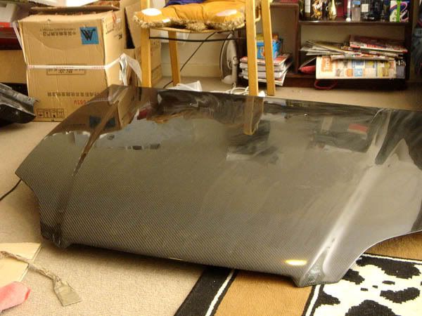

    Here is what my hood looks like before.
    3. Use 3M marine Wax with clean towel and work away. Follow the instructions on the packaging. Rub a few times with pressure and you should see your bonnet start to shine. Make sure you wipe away the wax straight away with your towel as it will leave residue and cause marring on your hood once dry.

    Here is what it looks like after a apply of wax. already looking better.
