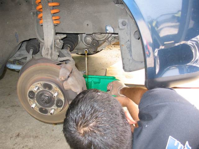

2. Next we need to drain the gearbox oil. With the car properly supported by jack stands, look through the driver side wheel arch and undo the oil drain bolt till all the oil in the gearbox is empty.

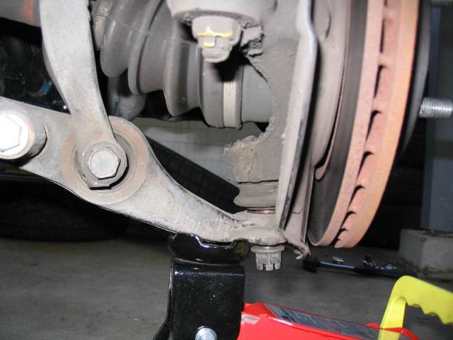

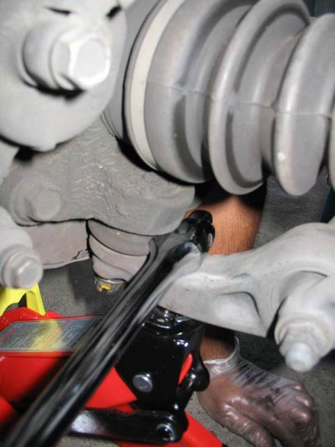

4. We now need to pop the lower ball joint out. Many people have trouble with this. Most people tend to hammer the crap out of the lower control arm (LCA) to pop the joint but there is an easier way. Firstly, jack the entire hub assembly up by placing the jack under the LCA. Then, take out the cotter pin going through the castle nut at the bottom of the ball joint. Undo the castle nut but don't take it off, leave it a few turns on the ball joint bolt. Jack the hub enough so you can wedge the end of your breaker bar (or ratchet/anything solid) between the lower control arm and ball joint holder like so:
Make sure its sitting securely. Then lower you jack and the joint should pop. If it doesn't, just use your foot and give the wheel hub a whack straight down. I took a little video of it and it sounded like this when the joint popped. Ball Joint Vid
The popped ball joint should look like this:

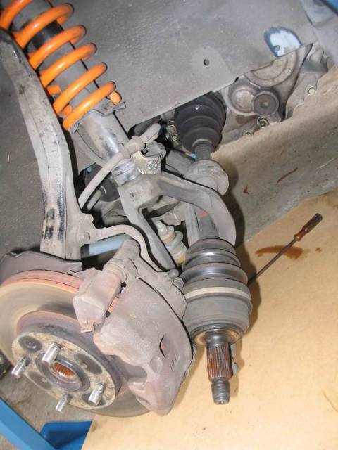

5. Once the ball joint is popped, push the tip of the axle through the centre of the hub (use an extension and a hammer to hit it through if its hard to just push it) and let the drive shaft sit out like so:

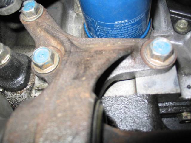

7. The passenger side driveshaft and intermediate shaft are a bit easier. After you have popped the passenger side lower ball joint and seperated the axle from the hub, simply undo the 3 bolts near the oil filter that hold the intermediate shaft in place. Once these are undone, you can just slide the passenger side driveshaft and intermediate shaft out together as a single piece. These are the 3 bolts holding the intermediate shaft:

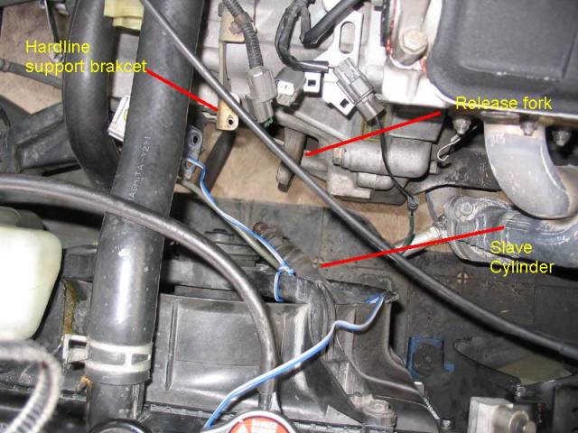

13. Now lets take out the clutch slave cylinder. Firstly remove the dust cover that protects the slave cylinder piston and the release fork. Then undo the 2 bolts that hold the slave cylinder hardline in place. Next undo the 2 bolts that hold the slave cylinder in place and then you can move the slave cylinder out of the way. We just tied the slave cylinder to the radiator fan bracket with some old wire! Be very careful that you do not bend the clutch hard line and also make sure you don't operate the clutch once this is done!

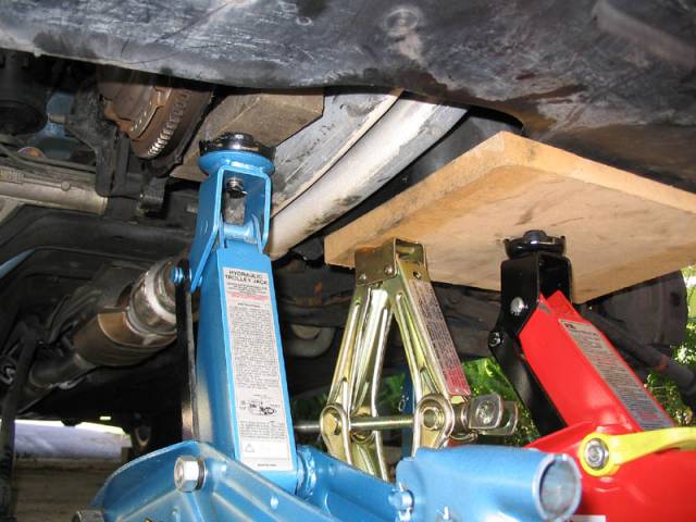

14. Now lets proceed to removing the tranny from the engine. We need to support the engine first, so place a piece of wood under the sump, and use a jack to support the engine under the sump (the wood prevents the sump getting damaged by the jack). You can use your trolley jack or even the stock honda jack. Jack it up till the engine/tranny rise up a little so you know for sure the jack(s) are taking the weight. I was paranoid so I used a few jacks I had he he he. Looks a bit like something from a construction site eh?

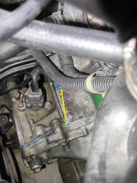

15. With the engine/tranny properly supported, lets get to seperating the tranny from the engine. Take out the 5 bolts that hold the tranny to the engine. I've numbered them the best I can in the pics (note there is one bolt under where the slave cylinder sits #1.

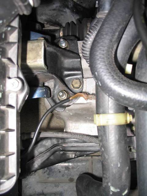

16. Next are the transmission mounts. THere are two on the driver side. The top mount and the front mount. Around now is a good time to put another jack under the transmission to help support it while you take it out. The tranny is not all that heavy, but its weight distribution makes it hard to handle.
Take out the earthing cable that connects from the car body to the transmission first (see pic below), then undo the 3 bolts that hold the top mount to the transmission.

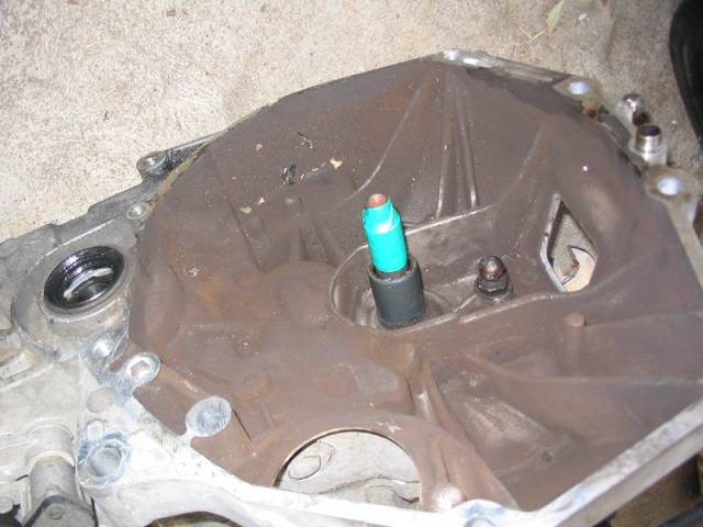

19. Lean over the driver side front quarter panel and (with a jack positioned with some wood on it, under the tranny) shake the tranny from side to side to get apart from the engine. We found the best way was to use a hammer and hit against the opening for the release fork a few times, then do the same on the opposite end, hiting the tranny against the diff casing. Once it is loose, make sure you support it properly as you slide the tranny out. Putting excessive weight on the input shaft splines could damage not only the splines and the input shaft, but also your clutch!

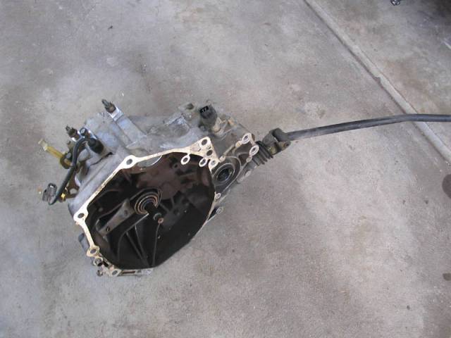

20. As I said before, I didn't seperate the shift linkage from the tranny, so once the tranny was out, it looked like this:
21. If you are going to do any work on the tranny, I recommend you tape up the input shaft splines to protect it. I used some electrical tape on it.
