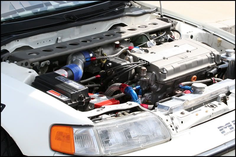

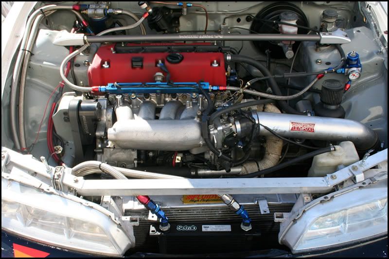

    Choosing an engine for a track only car, im choosing between a k20a2 or a b18c, but the way the k20 sits reversed in the (civic) engine bay looks like it put alot of its weight over the drivers side front wheel (along with the driver and seat).
    Whereas the b18c seems like it would sort of counteract the weight of the driver+seat, to give a more equal left right ballence after the crossweights are set.
    Id prefer to go k20, but if it reduced cornering ability, even slightly, id probably stick to the b18c. Can anyone say if the difference be noticable at all?
