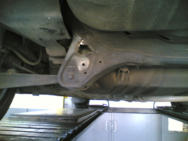

    Thx for the response guys. Well i took it to Midas & found out that it had nothing to do with the shocks. They put my car up straight away & found the problem.
    The swaybar bracket has been ripped out on the left hand side! I think the pictures speak for themselves:-

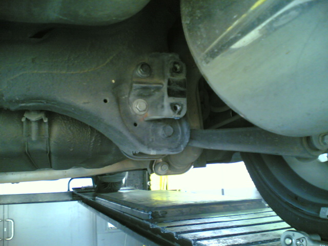

    This is how it should look:-
    They have taken off the swaybar for me. He said that I should take it to a panel beater & get it repaired. Any ideas what I can do now?

    take it to a panel beater and get it repaired.
    Also, once its repaired get a rear subframe re-inforcement from the likes of ASR. This will fix your problem.
  6. #6
    h0ly sh1t. look, at the WOE is me - whiteline swaybar thread. subframe tearouts have to be rewelded on and apparently cost $$$$$
    is it a whiteline bar? if so, let whiteline know, seeing they are currently doing some R&D on your car,.
  7. #7
    panel beater for sure, $$$$$$$$$$ for sure, i would hope it would cost no more than $800.
    friend of mine got a sill rewelded to his rex and cost him $600 looks about the same amount off work. get lots off qoutes.
