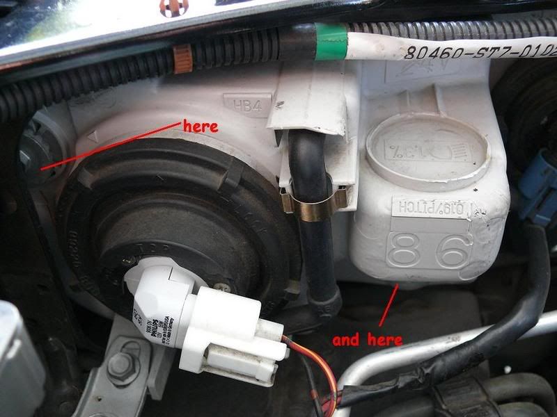

    2) Just took a pic, theres 2 small bolts, use a socket (8mm maybe) one is for pitch and the other is left to right, not sure which is which.

    Zilli....headlight adjustment...read here:
    http://www.team-integra.net/sections...?ArticleID=388
    best to have the lights against a wall...I put some tape where the beam was shining so I knew whether it was making any difference....sometimes looks like nothing is happening.

    I agree with not seeing much, you really need to keep winding the rings to even make the smallest of adjustments, in the end I gave up.
    also, the bottom ring for the vertical adjustment is on some weird angle, took me two three passes to see where it actually was. Also you can use a flat type screw-driver to adjust the screw.

    I found vertical adjustment was way quicker than horizontal..
