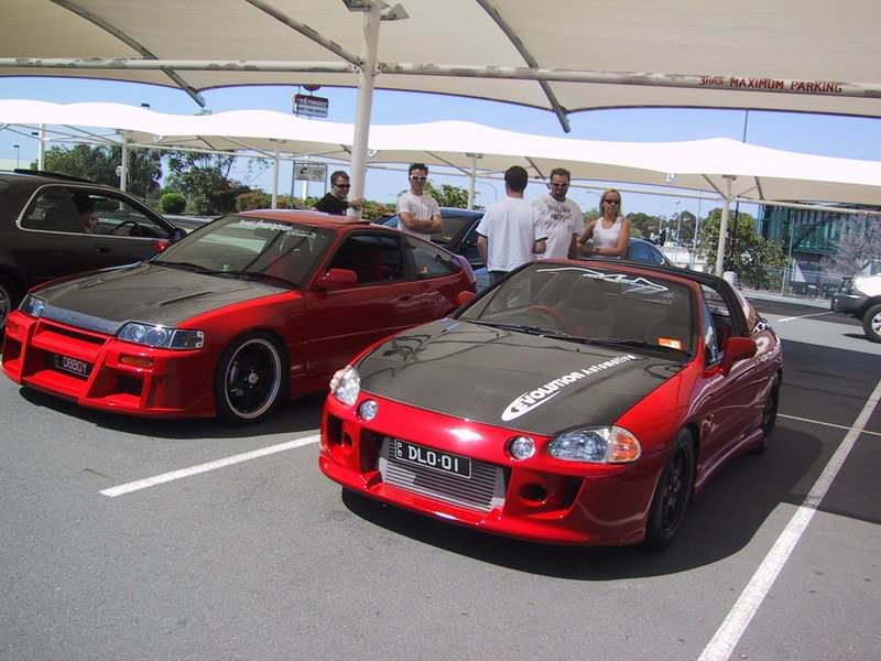

    I Forgot about my Crx. This was my venture in to hondas & boost:
    Car:
    1992 Crx Delsol
    Engine:
    B16A2 (Stock)
    Your kit/custom setup:
    Avo Stage 2 kit
    GT28R turbo
    Injectors
    Fuel pump
    Log manifold
    Avo Intercooler
    Excedy HD Clutch
    Excedy Light Flywheel
    2.5 inch exhaust
    High Flow Cat
    Magnaflow muffler
    GFB boost controller
    Pod filter
    NGK leads
    Management:
    Link Ecu
    Power output:
    135kw @ wheels. I have a dyno sheet somwhere, but don't know where it is.
    Likes, dislikes, trials, tribulations:
    -Very good kit if you want moderate gains and a bolt on kit.
    -Early boost, full boost at just over 3000rpm.
    -A good thing is that this kit was used without any cooling mods at all. No bigger radiator, no cooler thermostats, no oil coolers. And it never gave any problems.
    -Very fun little car, looks, open air driving, vtec and boost!
    -Kit not really expandable if you want more in the future.
    Pic:

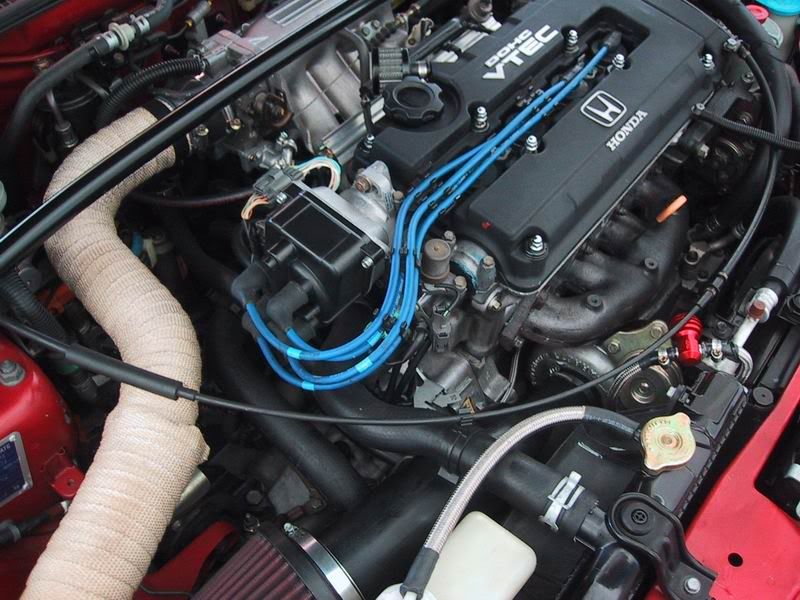

    Car:
    1989 CRX SiR (ef8)
    Engine:
    B16a1 (Stock)
    Custom Garrett ATP turbo- based off the gt30
    Tial 44mm Wastegate
    Blitz blow off valve
    Exedy Heavy Duty Cushioned button clutch
    ARC Intercooler (R33gtst model)
    Full Race Prostreet +AC turbo manifold
    Custom intake piping, stainless steel, powercoated charcol grey
    Custom Airbox, stainless steel, powercoated charcol grey
    KnN Pod filter
    Custom intercooler piping, stainless steel, powercoated charcol grey
    Custom 3" inch Dump and turbo back exhaust, stainless steel
    3" Metal Cat
    Xforce mid muffler
    Magnaflow oval muffler
    NGK irdium plugs
    GTR 440cc injectors
    DensoFuel Regulator
    Denso Fuel Pump
    Custom twin core radiator
    Davis Craig slimline radiator fan
    Apexi Radiator cap
    Management:
    Hondata stage2+boost
    Power output (dyno graph prefered):
    Highest power was 202wkws, but on Hub dyno, this is from Autosalon 07 with a roller
    -can drive like stock, fuel economy is almost the same as NA, quiet exhaust, turbo spool, suprising other turbos/v8s
    -dont hear much vtec as wastegate is loud, no traction on boost, gets hot in summer, no AC
    -HASPORT dont make engine mounts to suit ef8 so only OEM, alot of custom work as nothing else fits
    -Heat temps under the bonnet getting to high..paint peeling off rocker cover!
    Pic:
