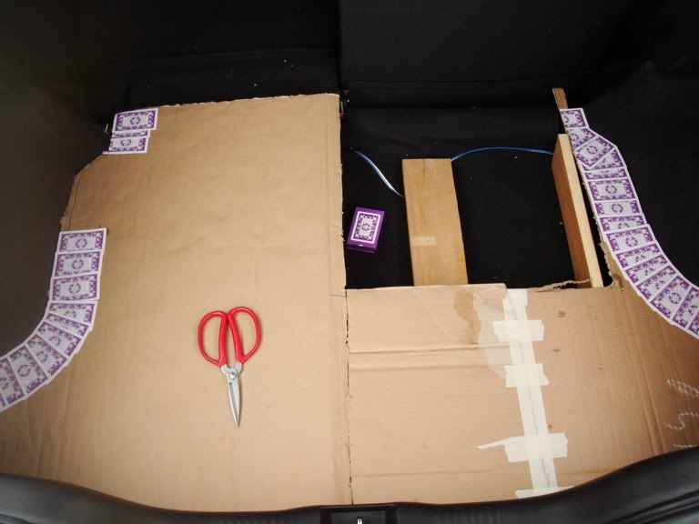

1. take the carpet boot carpet and those two side pieces out and lay them out over a piece of cardboard to trace. this will give you a general shape of the boot. divide it to where you want your two floors to be, i just put the division at where the rear seats divide. cut out your cardboard templates.

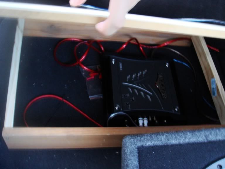

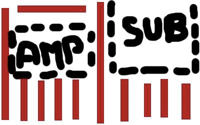

2. decide how much you want to raise your false floor by. keep in mind it has to be at least the height of your amp. buy some planks of wood that is the same height as this, and make yourself a supporting frame for your false floor. you can make a box like i did, or u can just use multiple planks as 'feet' under the floor
3. place your first cardboard template onto the support frames in your boot to whichever side you wish to work with first. you will find that the template will not shape the contours of the boot. push your cardboard template as close as you can to the side of the trunk.

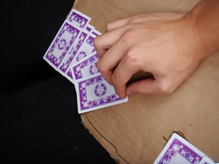

4. use your playing cards to shape the contours of the boot by sticking the card so that its edge is up against the wall of the boot. keep moving along the sides of the wall, having some overlap of the previous card. by the end of this step, you should have the shape of the side of the boot. repeat this for the other side too. these will be your templates with which you will transfer to the MDF board for your false floor
5. you'll find that after pushing the plain cardboard up against the sides of the wall that you'll now have a gap between the two sides, measure this gap and make yourself a piece of cardboard that will fill this gap, and sticky tape it to one of the template pieces, probably easier .
6. decide where you want your sub box to sit in your boot. place the sub box onto the cardboard template where you want your box to be in the boot, and draw an outline of it. cut this bit out.
you should end up with something like this now.

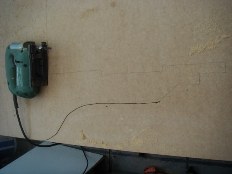

8. once you are happy with the fitment of it all, trace the template onto your MDF board. cut it out with your jigsaw.

10. if you wish to make an amp window, pop your amp on top of the MDF board and trace around it (or make it however big you want your window to be). cut this out with your jigsaw too.
