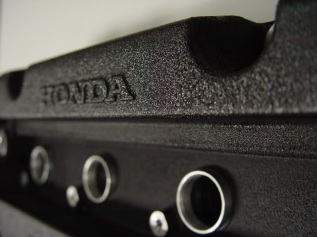

My K series rocker cover in  wrinkle black
							they look good, i should motivate myself and paint mine
Polished Nuts.
New polished grommet gasket
Painted spark plug wire cover.
OEM Type R oil cap.
