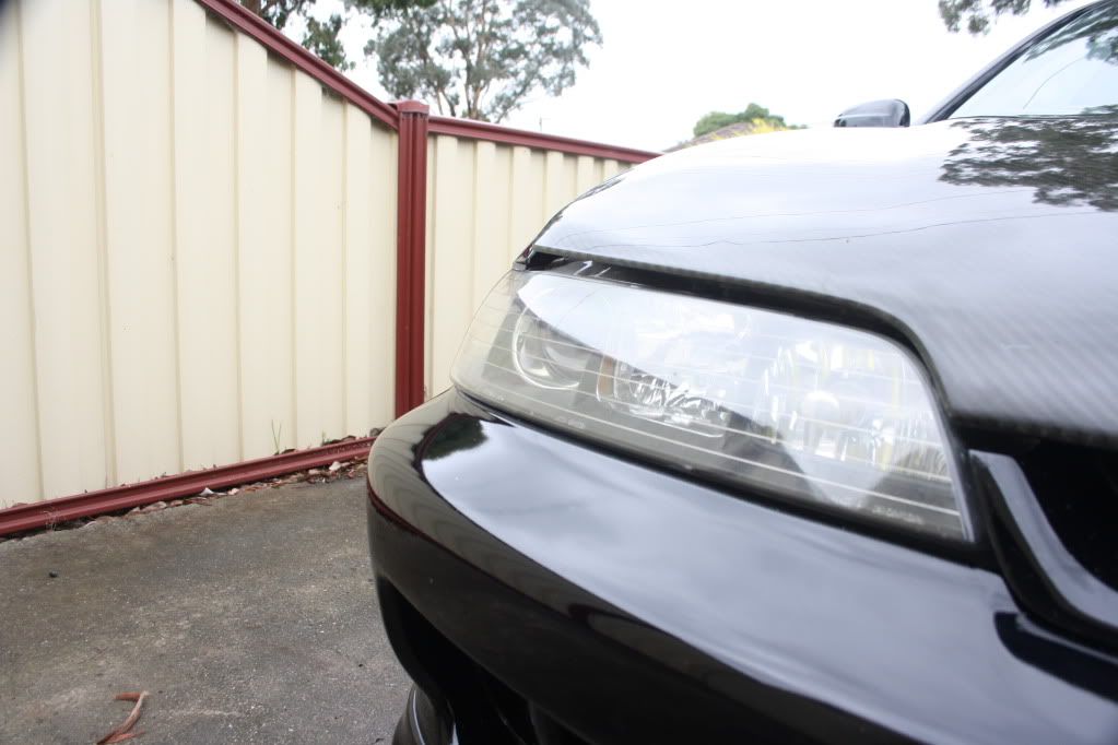

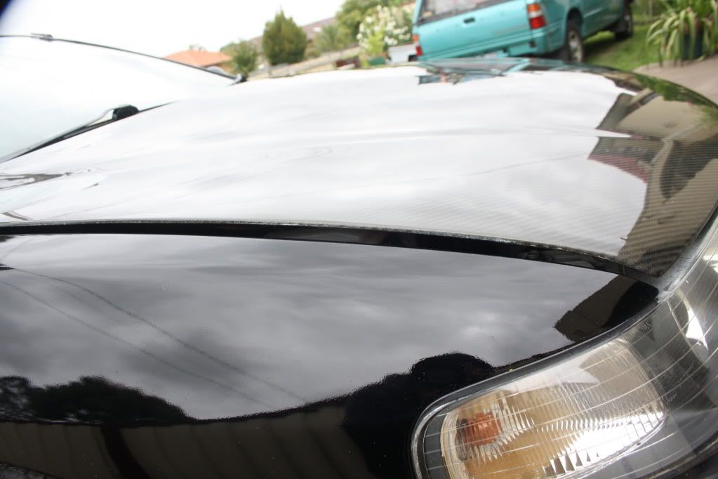

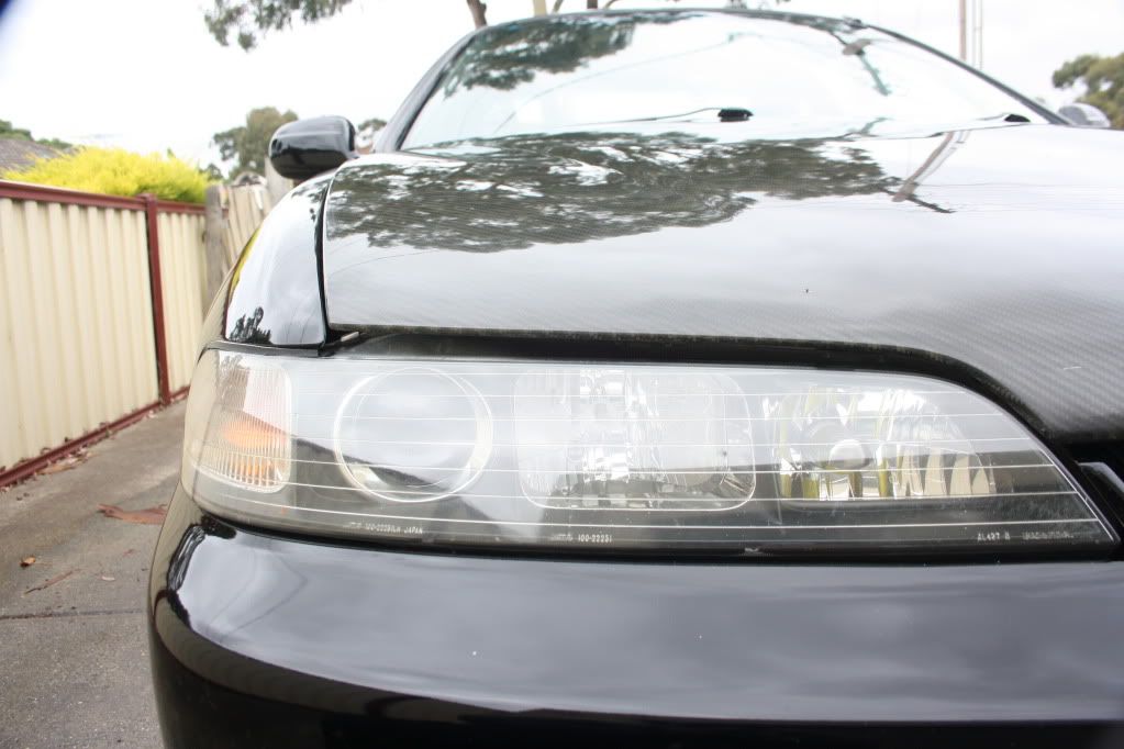

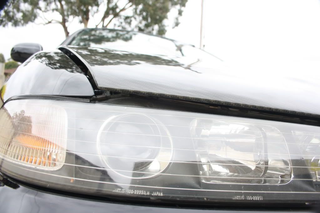

    hey guys i finally did my jdm front and i have 1 problem. it's my bonnet i got a cf bonnet and it's being a dick and not lining up properly, i've asked my friend who's a panel beater what to do and he said to put hot water on it and hold it down into place then pour cold water. i did this hot water thingo 5 times and it's not lining up i used weights to hold it down as well and poured constant hot water on it and it still pops out, did anyone else have this problem? here's some photos to show you guys what i mean

    if the new bonnet dosent line up correctly your raditor support might not be welded on perfectly stright...
    that's gay then -.-" then how was it suppose to be welded on?

    well when you were welding it up, you should have lined up ur fenders and bonnett first....

    Quote Originally Posted by dc5.taiger View Post
    Correct
    Quote Originally Posted by tiah313 View Post
    use bonnet pin
    If he uses bonnet pins to hold it down and gives it a hard gear change you can almost say goodbye to CF bonnet.
    Your panel beater probably didn't line it up with the bonnet and thus welded it too low.
