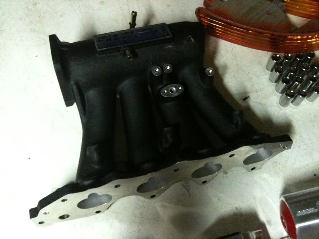

    What I did to my integra tonight:
    removed the stock intake manifold and throttle body because this baby came in the mail today:
    although this is exciting, taking the stock manifold of was THE BIGGEST PAIN IN THE ASS.
    the PCV valve broke when I pulled it out too, god dammit.

    Make sure you scrape off EVERY SINGLE remnant of the old manifold gasket off the head. Razor blade works well.
    And be very mindful of your knock sensor. The plug off the OEM manifold which is deleted when putting the S2 manifold on is in same section of harness as the knock sensor. When I did the swap I accidentally snapped my knock sensor in half. Limp mode is no fun :/

    Quote Originally Posted by Vvvtec View Post
    YESSSS!!!
    Yeah man I was careful, thank god mine didn't break *phew*
    sounds like it must've been annoying as hell.
