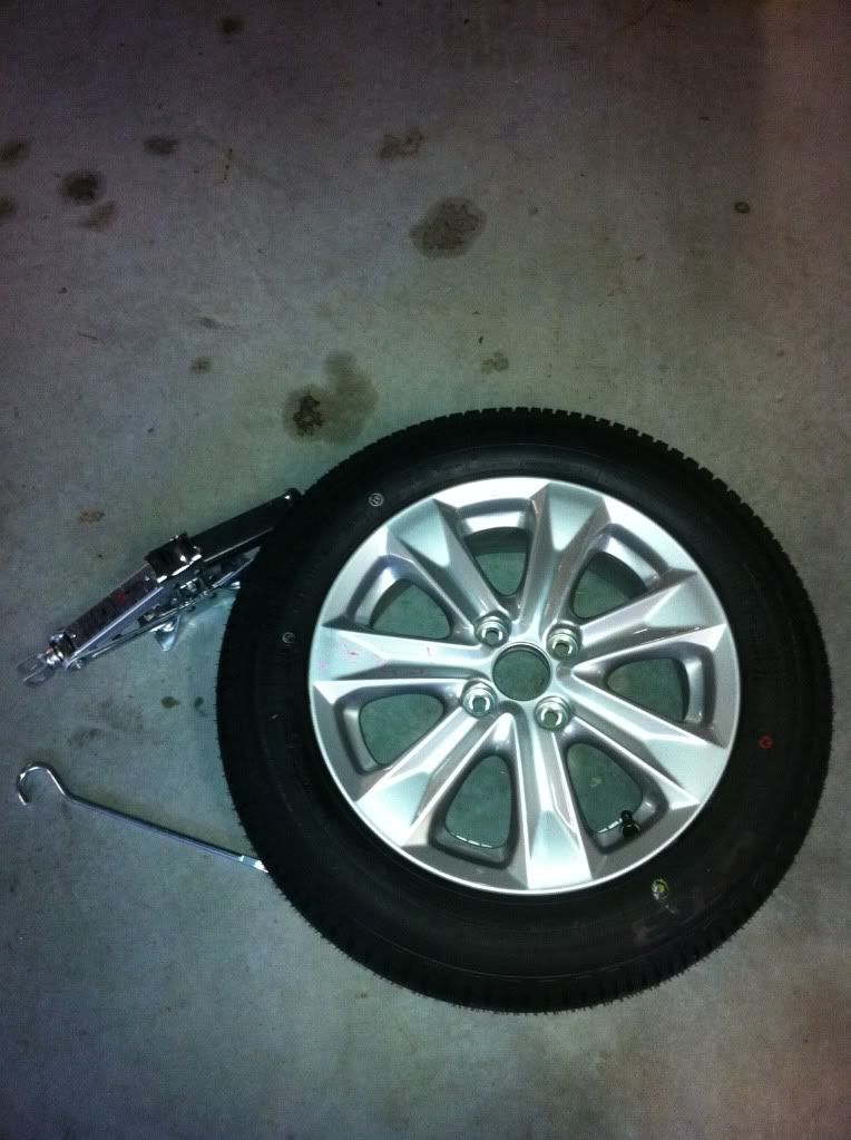

First off, I did the painting one wheel at a time. I used the spare wheel and switched it out every time i'm done with one.

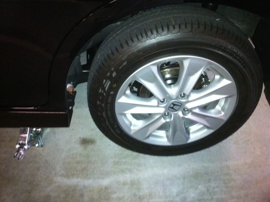

Took off the wheel using the jack that came with the car.

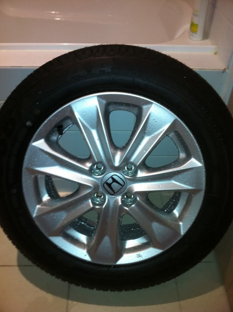

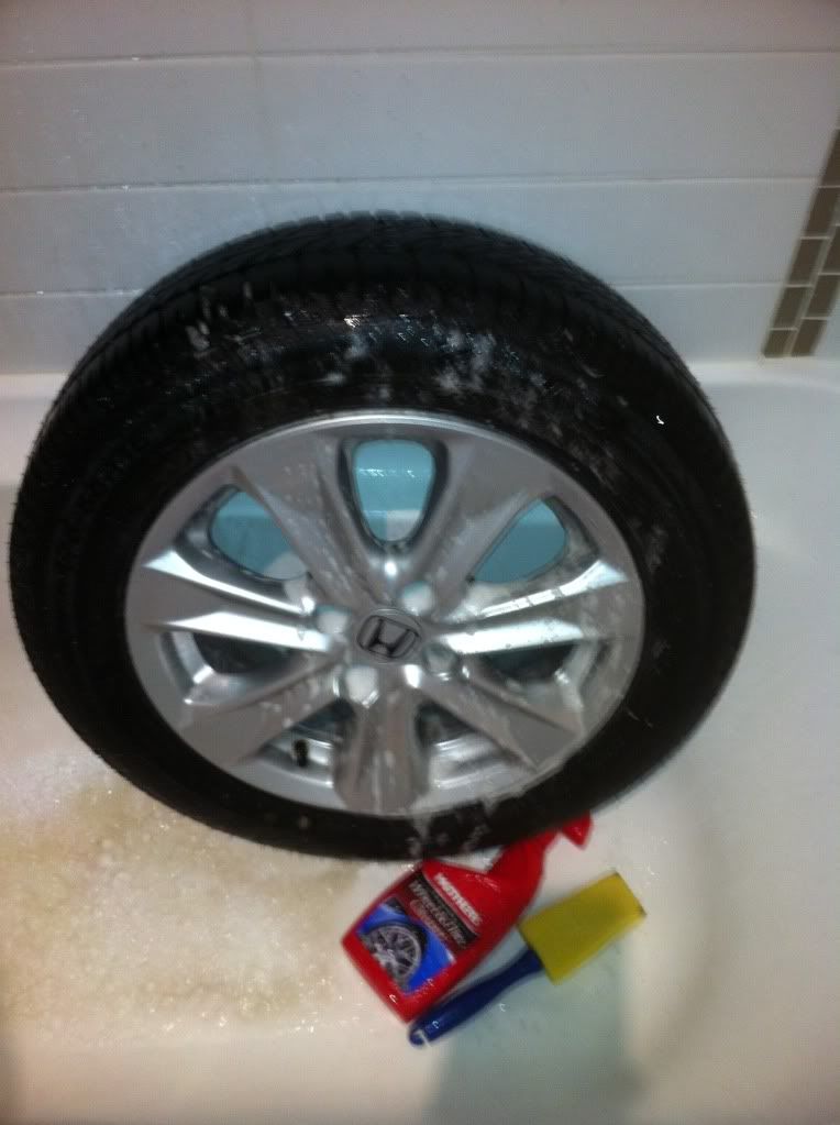

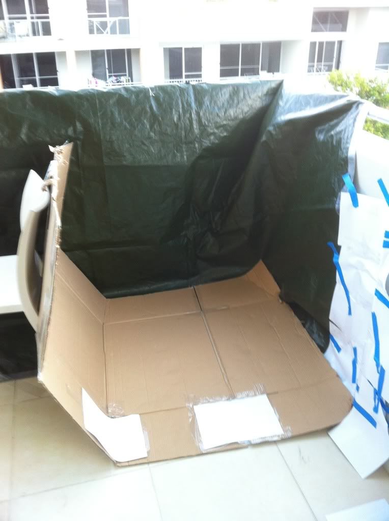

Washed the wheel fully, I stay in an apartment so I do not have a back yard. Washed the wheels in the tub and painted on the balcony.
My little paint shop.

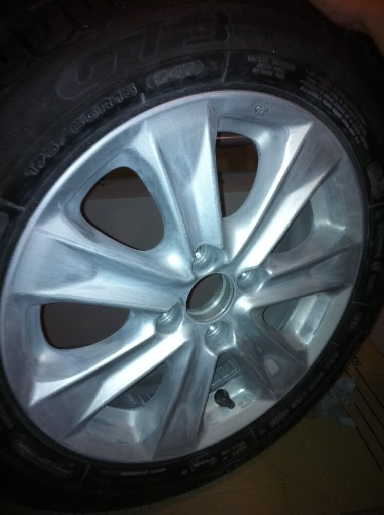

Sanded them with 400 grit sandpaper, be sure to get every place you want to paint especially around the rim area if not the paint and primer will not stick. Also you may want to wash the wheel again after sanding to make sure you get all the residue from sanding off. Just be sure to let the wheel dry fully before starting to paint.

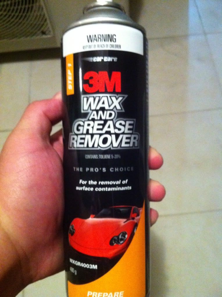

Then cleaned the surface down with wax and grease remover.

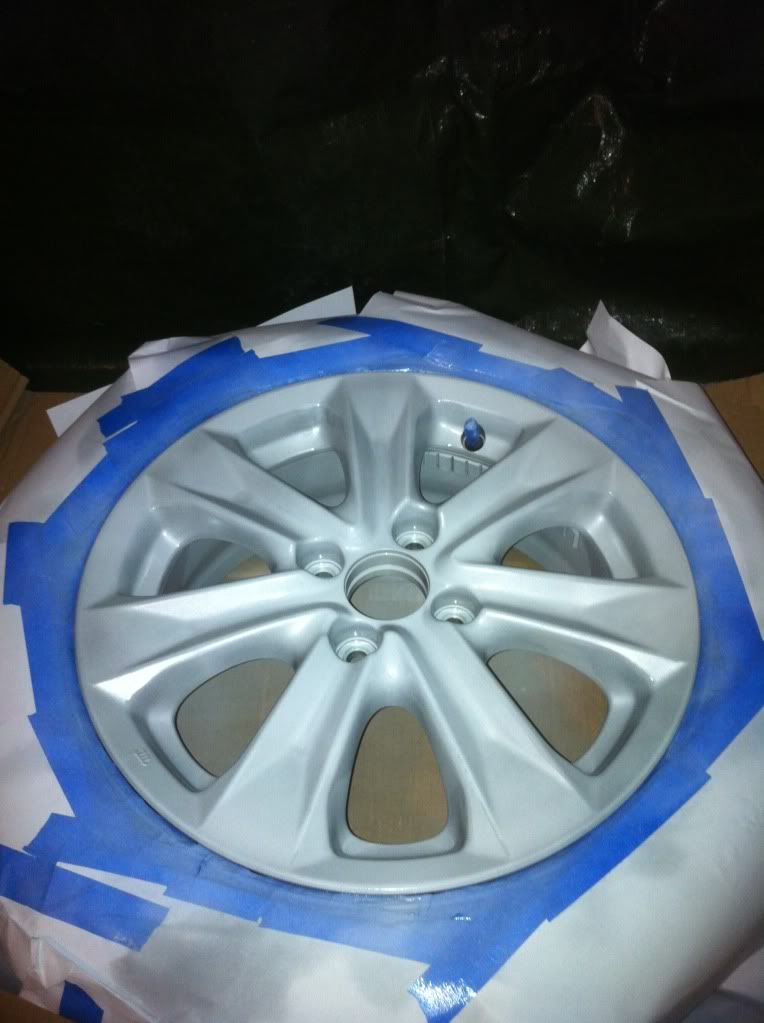

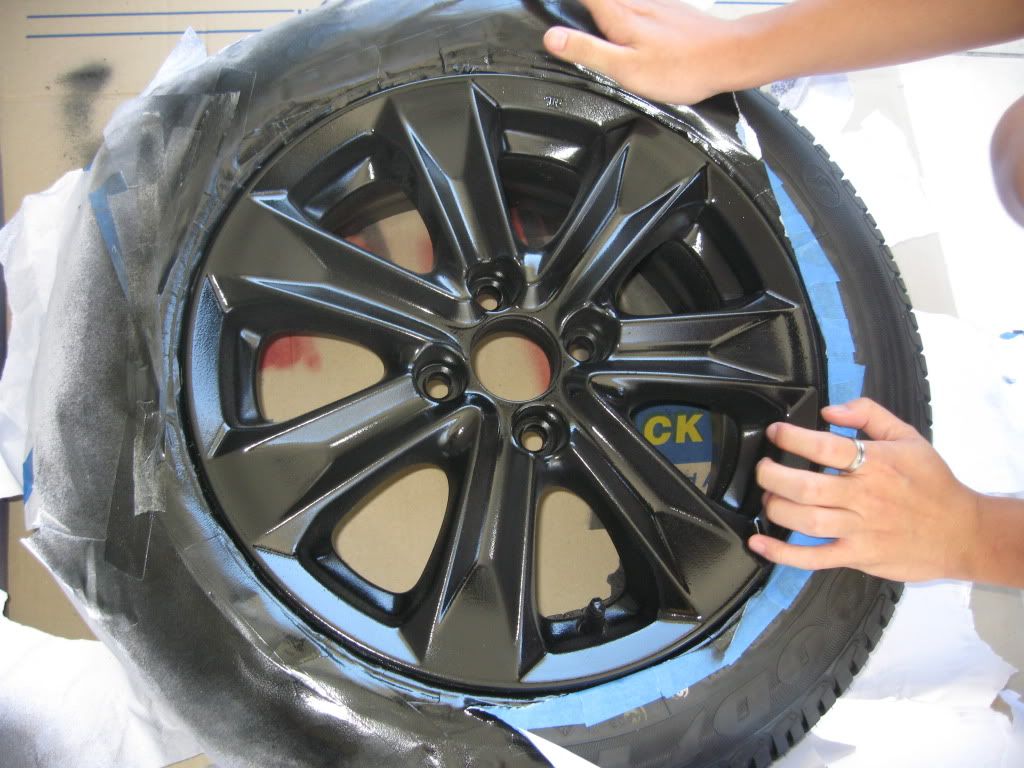

Taped it all off with blue painters tape and paper on the wheels. Also be careful with this part, if you don't tape it off properly you might remove some of the paint when your remove the paint later. Also make sure all the wax and grease cleaner is gone before you lay down the primer. As it can lead to bubbling of the paint. I used 3M etch primer.

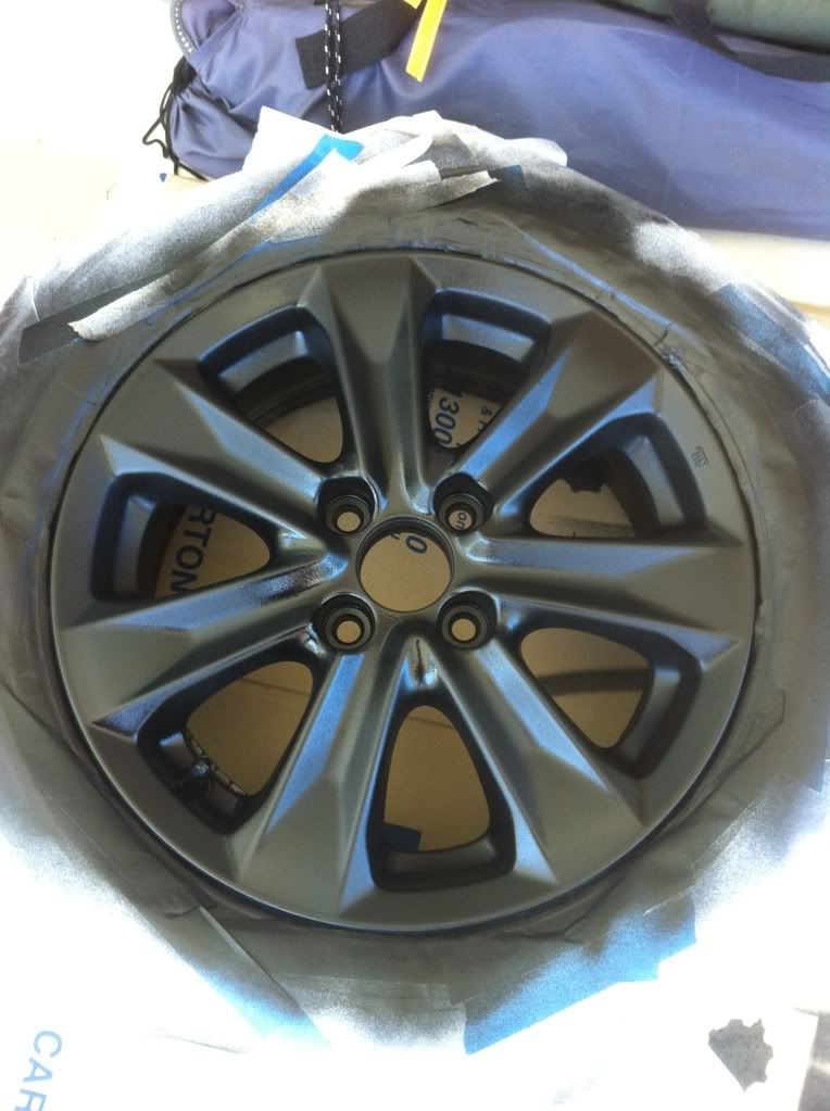

After the first coat of primer, I used 2 coats (back and front) then let it dry for 2 hours.

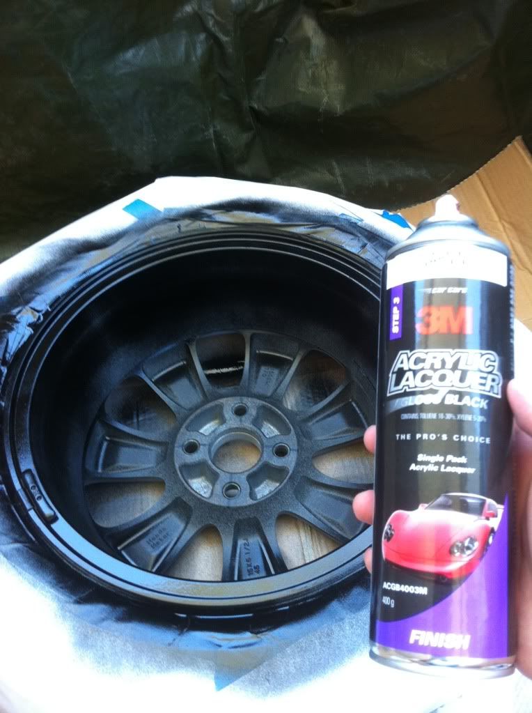

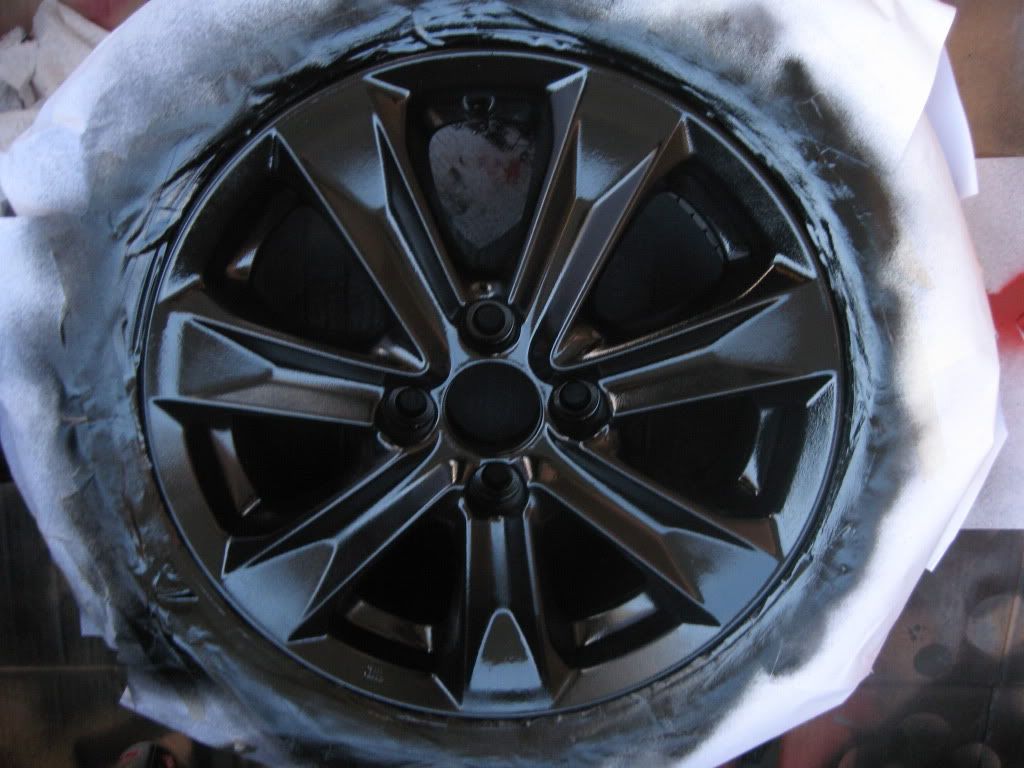

After the primer was totally dry, clear the surface of any dust or contaminants that may have landed on the wheel while drying. Then i started to spray the black base coat.
Be sure not to lay on the paint too think or you will get paint runs, had a few problems with that, but i managed to save the paint job by very gently wiping off the excess paint.
So once I've finished the back base coat, 2 coats on the back and 3 on the front. I left it to dry for 4-5 hours, depending on the weather.
Now its time for the clear coat. 2 coats on the back and 3 coats on the front. You want to lay it on thick but not too thick that the paint runs.

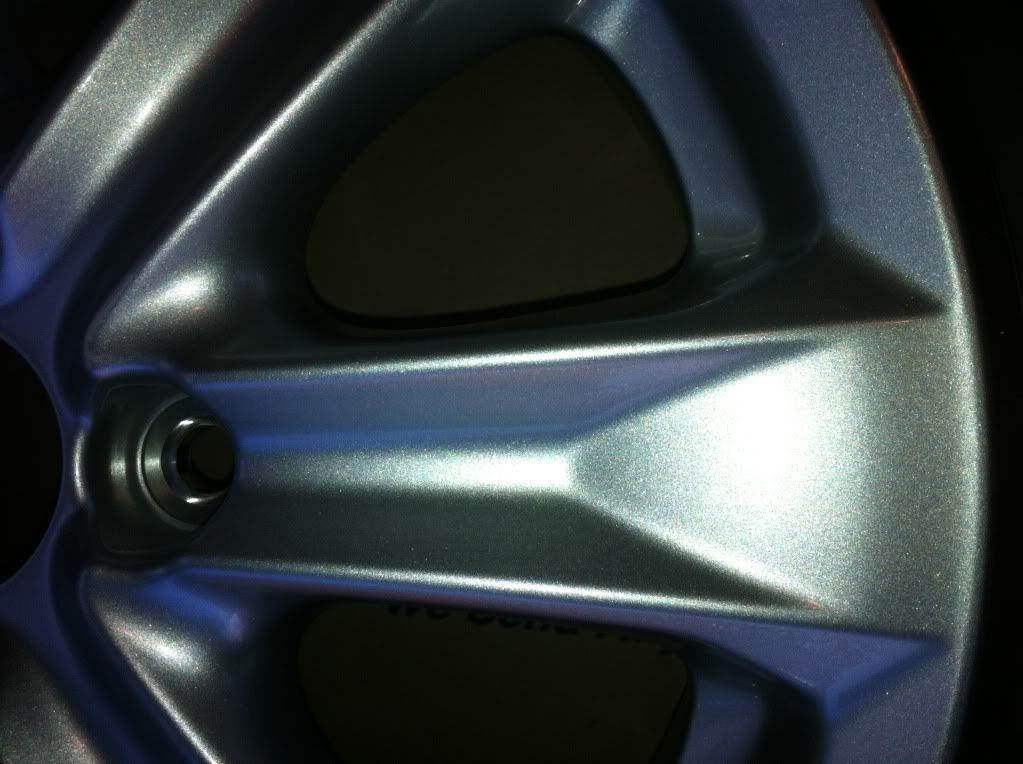

Finished product.

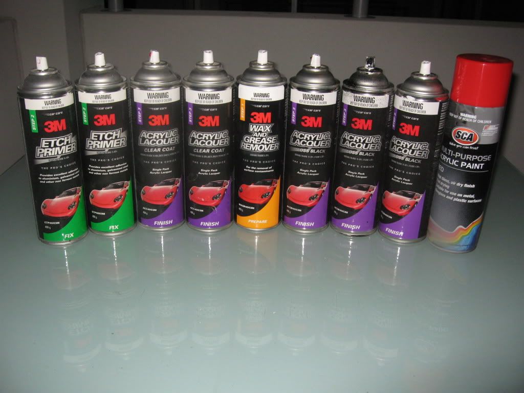

All the stuff i've used. Wanted to use calliper paint initially as it has primer in it and is pretty thick stuff but decided against it as it needs to get to 100c+ to cure fully and if its not cured apparently it is susceptible to solvents and chemicals and may come off.

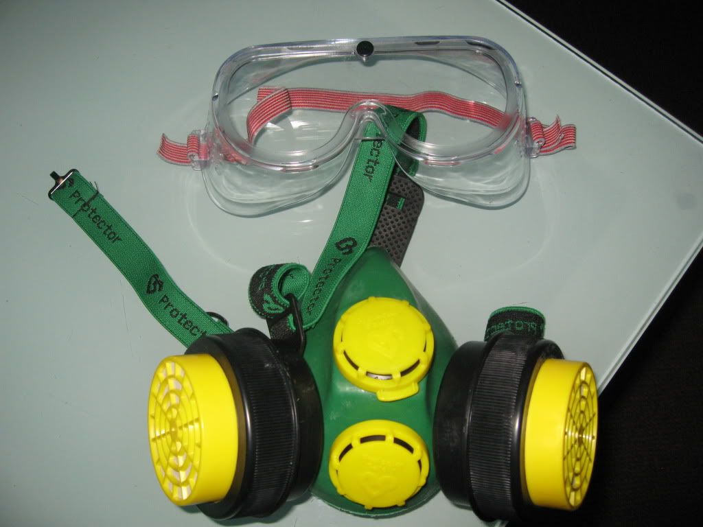

Also, safety was important! I started off with a cheap mask and no glasses. Got so dizzy and eyes were itchy. Then I decided to get some proper protection kit. Highly recommended!

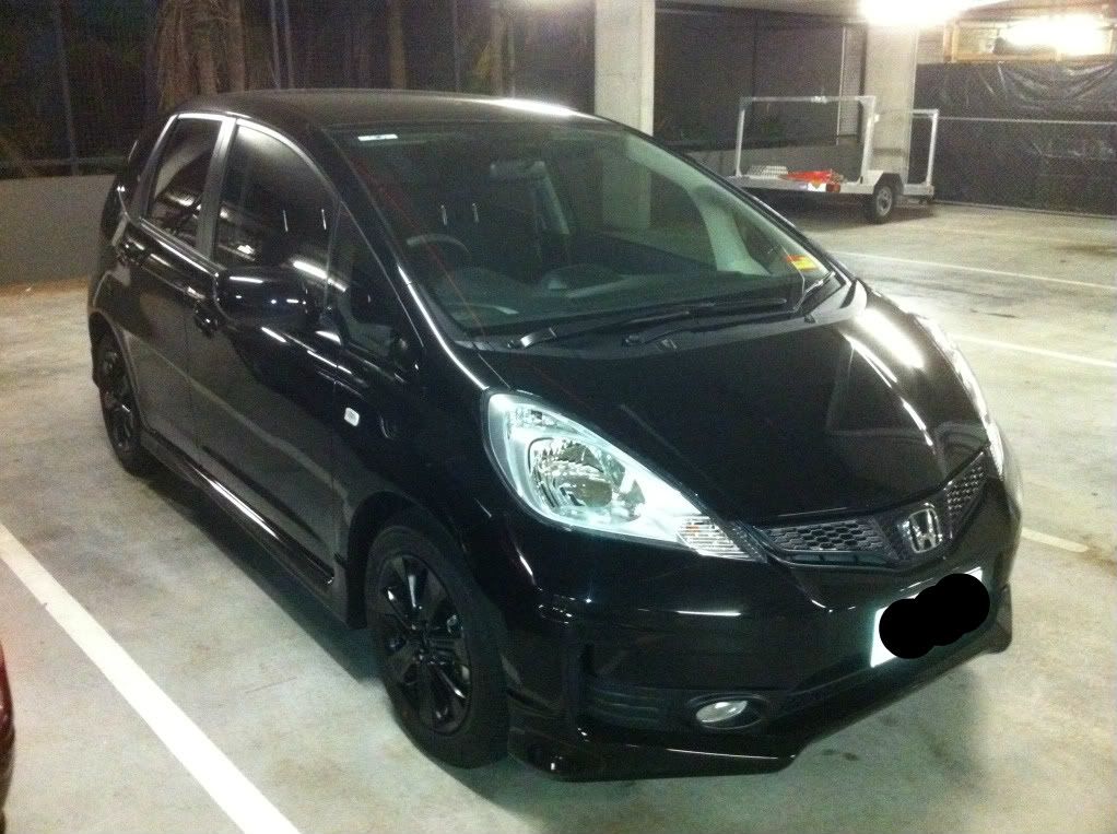

The car with tint and back wheels!
Got 5% on the front and 18% on the back.
