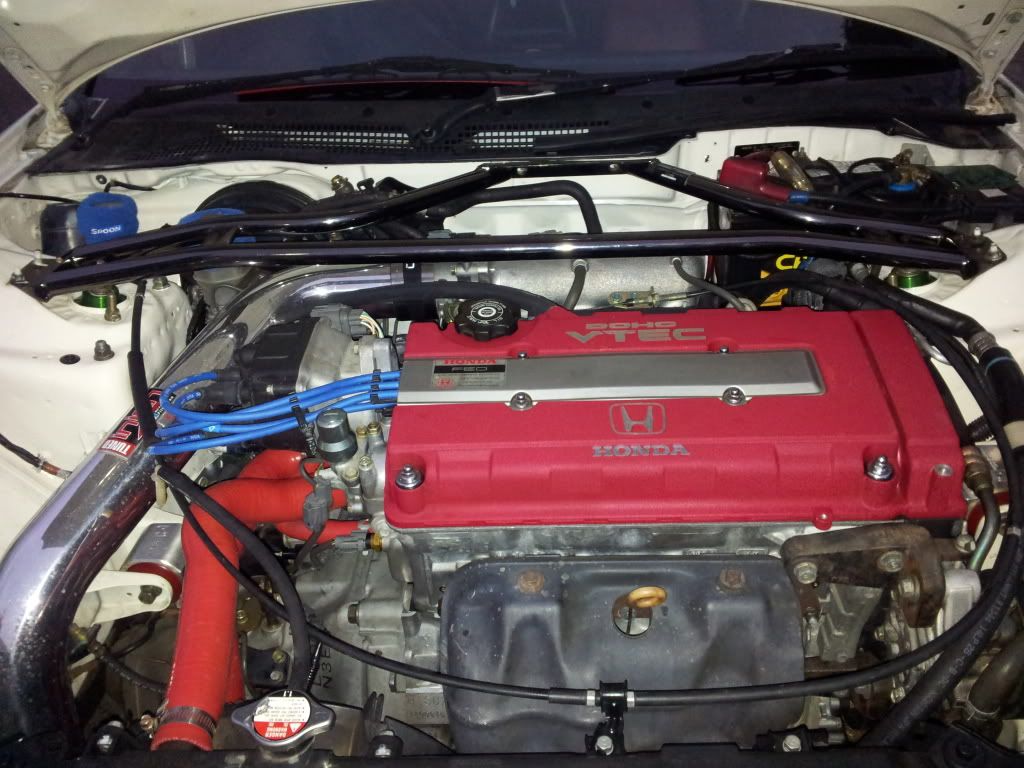

    are you sure? i just went to jdm yard to get one for my eg b18c. they gave me the ek b series one because they said the dc2 airbox sits different to the eg.
    this is how my ek b series one fits, i know my engine bay is a mess but yeah was finishing putting the engine back together
    and the injen cai doesnt look straight because it wasnt bolted down properly in the photo but you get the idea.

    If you have a b16a in ur eg ---- then yes, you use a Ek4\Em1 injen intake
    Op say b18c7 - So he will need a Dc2r injen intake
    Ek4\Em1 injen intake piping is 2.5 - 2.75inch cant remember
    Dc2r injen piping is 3inch which is dyno proven for type r b18c7
    You shouldnt be using a Ek4\em1 injen cold air intake with a b18c7, to small for that engine

    ohok. well thats JDM Yard told me. I will measure it up, id be spewing if they gave me one which didnt perform as good as it should. Does it really make a bit of a difference though.

    If you have a type r engine , then yes to small for it

    yeah definitely smaller than the tb, had a look yesterday.... arghhhh! would it be much of a loss of power?

    I would say u would lose alot of top end and gain some low- mid end
