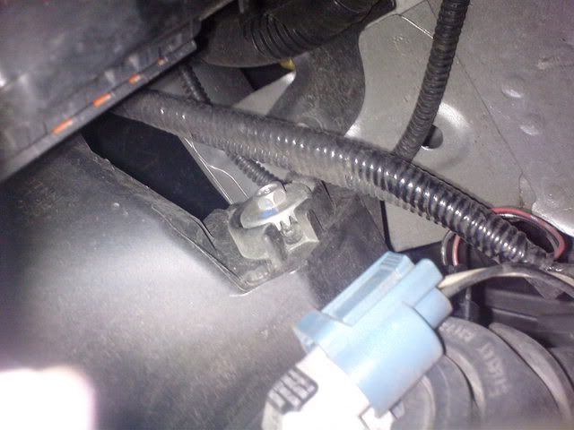

 Originally Posted by JDM EP3
Anyone know how to adjust the headlights on the EP3?
If you pop the bonnet and look at the top of your headlights, you should see the letters U - D (Up & down) and L - R (Left & Right) with arrows showing which way to turn to adjust. You should then see little slots where you can put a long philips screw driver in to turn the dials. The one just behind the high beam adjusts the light Up and down. The one towards the side fender adjusts it left and right.
The little metal thing is what the slots should lead your screwdriver to, the head of the screwdriver will meet with the teeth of the metal thing and you just turn to adjust.
Hey man thanks for that info, its really hard to make out the letters for U-D I couldnt actually make them out. So the up/down screw is the one furthest away from the fender?

The up & down screw should be the one just next to the high beams so yea it's the one furthest away from the fender; you should be able to see it easily on the drivers side light. From my memory I think turning it anti-clockwise (facing the front of the car) will move the lights up and visa versa.
btw, my info is based on the FL headlight, but it should be the same
