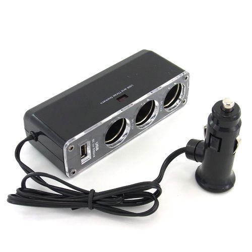

    is this what you have bought?
    if not get this and problem solved!
    RB1-ODC

    That's ugly
