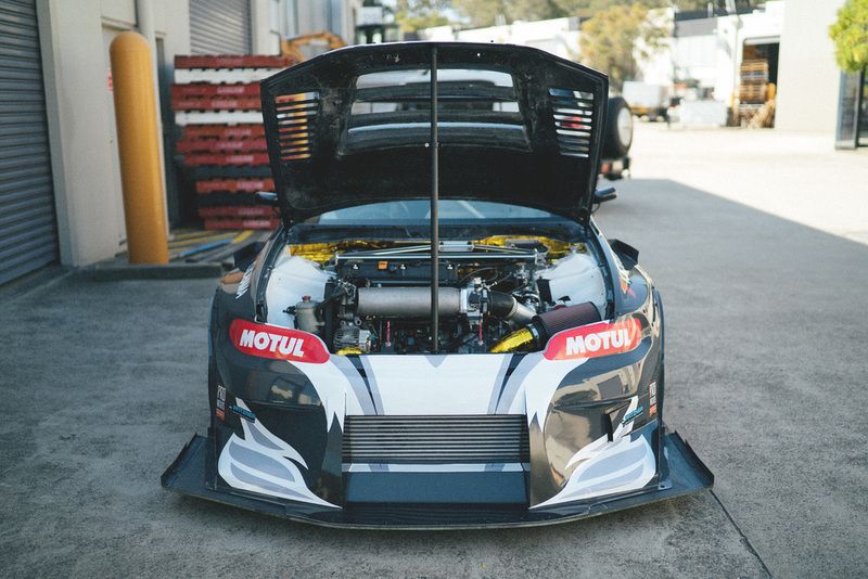

A full house K24, supercharged Honda motor provides more than adequate power. The team certainly left no stone unturned in this build and the engine bay now sports a full house K24 Honda engine complete with a big ROTREX supercharger hanging low down in front of the engine. The power is fed to an LSD via a PPG straight cut dog engagement transmission.
The guys told us the setup makes “just enough” power and that it “should do the job”. As is so often the case these days, the teams that have invested so much in the development of their car tend to be hesitant about giving out too much information especially if it could potentially give the edge to their competition.
Knowing how easy these engines make power, we would have to assume the power output would be somewhere between 550hp and 600hp.

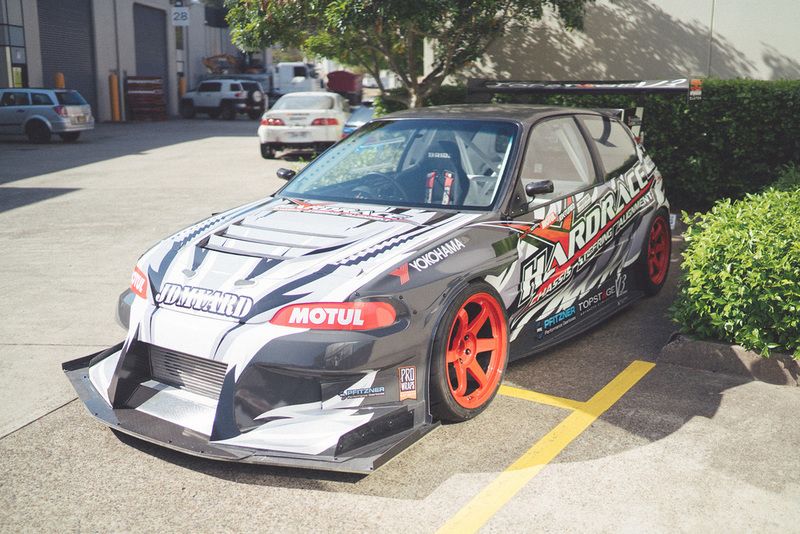

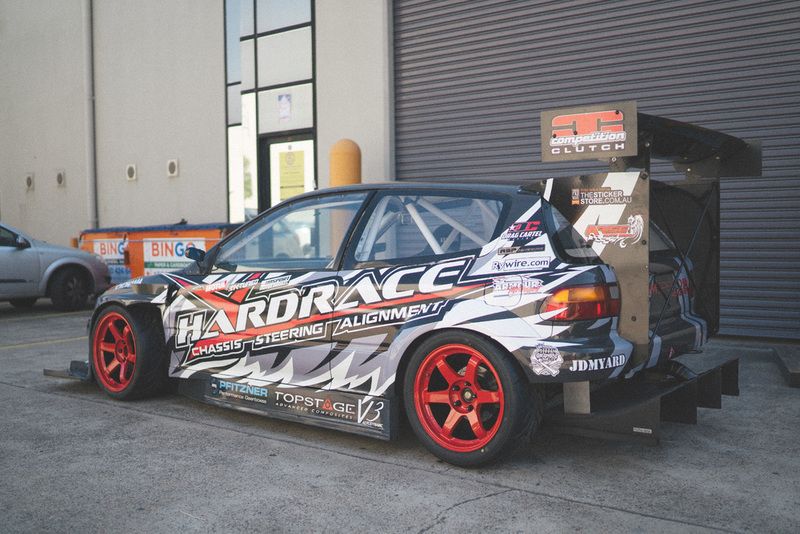

The aero package has been thoroughly updated for 2015 and will provide the car with much greater downforce.

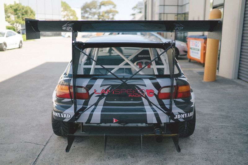

The car now wears a heavily revised aero package that includes a trick new rear wing with enclosed sides that are designed to aid in lateral stability and much more intricate side skirt arrangement. Most of this was made possible through a partnership with Melbourne based aero manufacturer Topstage Composites who have been instrumental in both the design and manufacture of the carbon fibre components.
Cleverly designed deflector plates can be spotted all around the car.
“Even though the Open Class is restricted in aero size and the fact that flat floors are banned, there are still massive gains to be had in getting the aero package right and we have spent the past year doing just that.” said Fred Souergino from Top Stage Composites “We have put a lot of time and effort into this one and we are starting to see the results.”

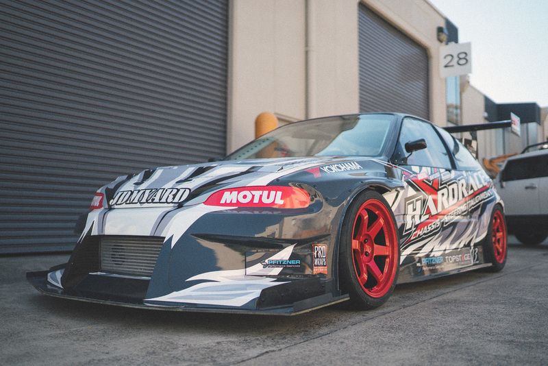

The front end now features a custom nose cone and splitter designed to work in harmony with the rear.
“The front of the car is one area we have paid a lot of attention to and we designed it to the absolute limit of the Open Class rule book” said team principle Zie Yap. “When we bolted the whole thing together I went and ran the tape measure over everything and suddenly the bottom of the front bumper was a few millimetres over the 150mm allowed.”
“So not wanting to take any chances I pulled it apart, boxed it up and shipped it back to Freddy and had him modify it. After spending this much time and money I would rather get to sleep at night knowing we are 100% legal.”

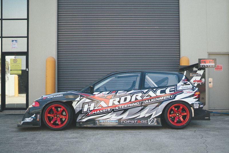

JDM Yard is the Australian dealer for HARDRACE products so not surprisingly the car was wrapped in a stunning HARDRACE livery.
