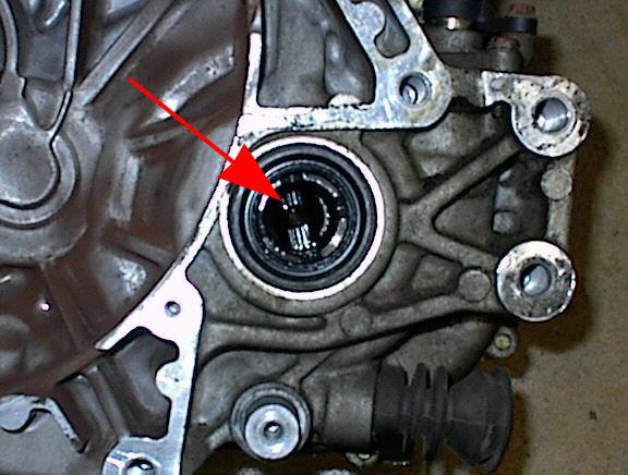

ummm i have no idea then, i wish we new exactly what was in it, someone told me that, i have no real idea myself what is in it yet, soon to find out. Is it easy to tell when they pull it apart?
Easiest way is to pull the axles out and check it out.
If you see this 'bar' , your tranny is equipped with a stock differential.
While the tranny is off the engine, take a look in the differential area. If you can see straight through it, WITHOUT any obstruction in the way...
You have an LSD equipped tranny.
Hope this little info help abit.

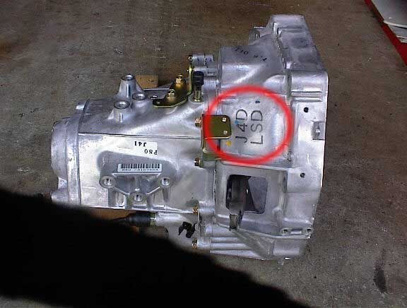

A real easy way to see if you have an LSD tranny, is to look for the 'LSD' stamp on the front facial area seen here..
B-series Hydro type (ITR) tranny shown on pic
The 'LSD' stamp could be decieving at times, if you're not careful. Some bad people like to pull out the LSD, replace it with a stock diff. and resell it saying the tranny IS LSD equipped, when it's actually not. That's why looking throught the differential hole is the sure way of knowing your buying an LSD equipped tranny. So be careful...
