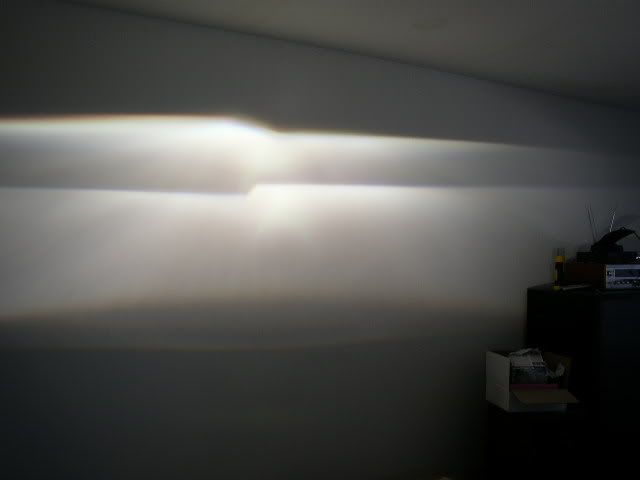

The difference between left and right hand drive projectors is which way the step goes. With a left hand drive vehicle, the light will step up to the right, with a right hand drive vehicle, it'll step up to the left. This allows you to not blind oncoming traffic, but sep up to illuminate the sidewalk and such.
For demonstration purposes, here is the output of an LHD projector and a RHD projector
disregard the fact that one step is bigger than the other... that's the difference between an ece cut off and a dot cut off... point is to show the top one is from a RHD projector, and the bottom is from a LHD projector
thanks Saxman. Those last 2 pics show the difference very well. I'll have a look at my set up tonight and compare.
When I look at my HID's head on there is definately no glare as demonstrated in the Mazda3 image, the light is very focussed so perhaps I have Valeo projectors (would these be OEM in Subaru?)
So what I'm interested in now is if the light projection is even across the front without any hotspots, I will check that tonight.
