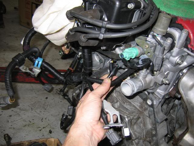

as in can u tell me what wire colour is on the left and the right ??? as the wires of the plugs was taken off and just left hanging, now i dont know which one is suppose to be on the left or right? ... its a 2 wire plug - ITS NOT THE GREEN PLUG WHICH IS ON THE LEFT OF THE SOLENOID SINGLE PLUG - the one im talking about is the one on the FAR RIGHT!!
cheers!
if its a green connector then its VTEC pressure switch, if its Grey it will be ECT
doesnt matter what the polarity is.
can you tell us what colour the wires are. it will help in indentifing the connector.

(see pic below, this pic was taken from my mates B18C which has the same plugs as a sample)
3rd plug is a 2 wire plug which has a fat black/yellow and black/white.
(see pic below, taken from my mates B18C as a sample)

sorry fellaz for the crappy pic , i hope it will help abit ..

BIG HELP IS NEEDED!!! any suggestions - but i am really concerned about the massive plug that is not connected to anything as above pic.
connector 2B is the connector that has some of the following signals
- ICM igniton modual
- revers light switch,
- coolant temp sender
- oil pressure switch
- stater motor signal
and a few more things
the blue wire is tacho signal and does not connect to anything
