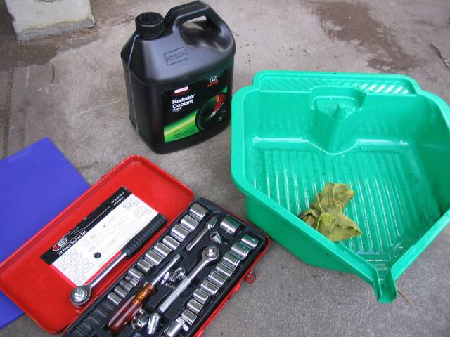

Aim: Refill/bleed the coolant for the cooling system
Required:
- 12mm socket / spanner
- 19mm (I think it was) socket.
- Approx 4-5L of coolant (you can buy it premixed from Honda. Approx $32 for 4L)
- Something to collect the old coolant with (I used my oil pan)
Steps:

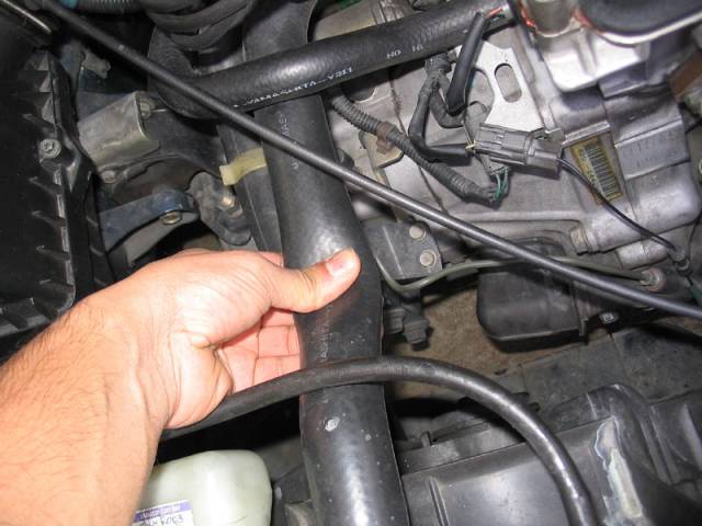

One way to check is to squeeze the top radiator hose. If it is firm, the coolant is still under pressure and hot! (pic below)

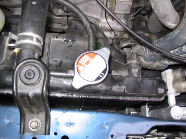

2. Remove the radiator cap.

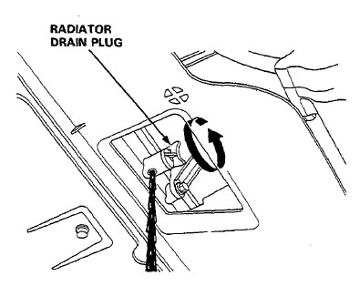

3. Loosen the drain bolt at the bottom of the radiator (you don't have to take it out completely, just enough so the coolant starts draining). I didn't jack up the car so couldn't take a decent pic. But its basically like this:

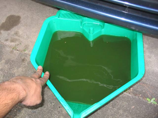

4. Take out the engine drain bolt and let the coolant drain out completely.

8. Pour the pre-mixed coolant (if it is not premixed, then make sure it is a 50-50 coolant/distilled water mixture) into the radiator via the radiator cap opening upto the filler neck.

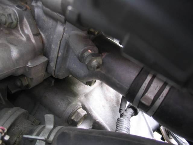

9. Loosen the bleed bolt (12mm) at the top of the uppermost radiator hose until there are no airbubbles coming out and just a steady stream of coolant. When you tighten it back up again, make sure you don't over tighten it (9.8Nm is fine). The pic below is for a DOHC-non VTEC engine and is located behind/underneath the dizzy. For SOHC engines it is located on top of the radiator hose at the front of the engine above where the engine number is stamped.

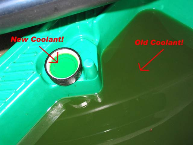

Just as a comparison.......the pic below shows the old coolant and the bit of coolant in the cap is the new coolant. Notice the difference?
