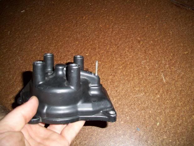

 Modifying the stock distributor cap.If MSD does not have a distributor cap for your application,then you will have to modify your stock one.
 Here is the full DIY - Modifying the stock distributor cover to accept an external coil
 MSD sell a 'MSD power tower' Here's what they look like:
 I bought one and had to modify it to suit my dizzy but you can see in the pics,you don't need to buy it and can make it up ya self,just as good,better,from these 3 parts:
 It's just the tip of a sparkplug:
 You will need to find the appropriate thin drill bit for the job.Then you need to drill a hole straight through the cap and screw the screw through there,like so:
 Put the other bits on:
 Use some gasket sealant or silicone to seal it up/insulate it,or you'll get zapped,like I did
 Inside aswell:

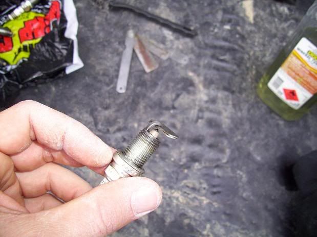

 So routinely I do the following:
 Remove plugs,clean the spark plug holes,sparkplugs and set the gap:
 The handy tool
 Put 2 or 3 tissues on the end and swirl em' around:
 NGK Iridium's all the way! 60,000km and going strong!!
 EDIT: On one of my NGK's,it was allowing oil up into the sparkplug cylinder because the crush washer was completely flattened after taking them in and out a few times.This was causing misfire.It only happened on one plug and I took them all out and in a few times...just know this may occur cause I have had misfire problems on and off for a while and now I finally know what was causing it.
 atm it's a 1.6mm gap.I have ran it smoothly at 1.9mm before,misfired at 2mm:

 dont like the cap setup either,see if u can insulate that power post a bit better,otherwise misfire here we come again.

 The power tower is 'alive',it zapped me,do you know if on MSD caps if the tower is alive? I think it isn't...

 i assume u werent silly enough to touch the post while the motor was running beez?
 leave that kind of thing to ronny,hes immune to it now lol,i think he actually gets a hit off it.
 if it zapped u after motor off,its a capacitive system & was prob still holding charge just enough to wake u up a bit.
 insulate that post or it will leak after a decent amount of dirt/moisture/etc builds up around that area.

							Cheers CRX'er will do.Will the capacitor not prevent those things,obviously a capacitor is not a fuse?
 Yup! I touched it while the car was running,damn ya know about it,a mild electric shock!
 So I should insulate it where the post meets the cap?
