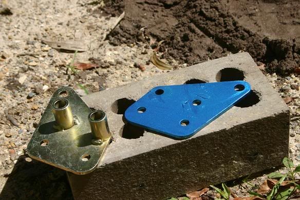

Review:
Whiteline :
pro's- 3 mount (no plucking)
con's - places the swaybar d bracket further out giving it leverage to tear you subframe; no linking b/w reinforcements (tie bar provides no twist torsion which is what is needed most).. LOOK AT WHERE THE SWAY BAR MOUNTS TO THE REINFORCEMENT...
Beaks :
Pro's - use larger sway bar; keeps oringal mounting width (less leverage for twist);
con's - no linking b/w reinforcements (tie bar provides no twist torsion which is what is needed most);
ASR :
pro's - keeps original mounting width (less leverage for twist); connecting plate for torsion twist purposes....
YOU SEE HOW THE MOUNTING HOLES ARE ALIGNED AND NOT PLACED ON THE OUTTER SIDE
