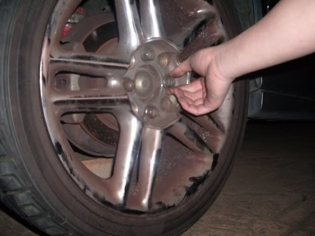

Aim: Take off a wheel, and put a wheel back on.
Required: Jack, Socket Bar (standard), Car with rims.
Steps:
1 - Find the car - Okay, here is the car, this is the wheel we are going to take off.
2 - Without touching the car, grab the socket bar
3 - Without jacking up the car loosen the lug nuts about 1/2 a turn to 1 turn MAX each, just so that they are loosened. Remember Righty tighty, lefty loosey
Other comments:
At this stage if you bolts are on VERY tight and you cannot get them off, you may need to use a breaker bar, which slides over the top of the socket bar and adds length the bar, hence increasing the leverage you have thus increasing the moment force which you can apply on the lug nut, thus making it easier to turn.
If this doesnt work, get a rubber mallet. Hold the socket bar and gently tap on the socket bar whilst holding it firm. Ensure that the socket bar fits you car, you may need to use a socket set instead, or your respective lock nut.
Loosen the bolts opposing each other. Ie, Always go North, South, East, West. Not North East, South West. Make sense?
So now you have loosened the lug nuts, but you still cant turn them? Thats cos the wheel is still putting pressure on them. here is the fun part.
4 - Jack up the car.
a - Take out the jack set.
b - assemble the jack
c - Make sure that the bottom of the jack is on a stable and flat hard surface (concrete works well). The positioning of the jack is of utmost importance, it is important that the jack makes contact with the chassis of the car, not panels, as these will not be able to support the weight of the car. In this case, i used the tow hook as my jacking point.
To raise the car, wind in an clockwise motion.
Alternatively you can use a hydraulic jack which makes the work a lot easier. Once again, check the jack locations on the car and on the ground!
5 - Now your car is jacked up, and the wheel is just off the ground.
6 - Use the socket bar and remove the lug nuts. you should only have to loosen it a bit more, then you can do it by hand. Remember. North, South, East, West.
7 - Once you have remove all of the lugnuts, grab the wheel and pull it off towards you. Be careful of the brake dust, wheels get very dirty as u can see with mine.
To put the wheel back on just do the reverse. Put on the lug nuts North South East West and hand tighten the lug nuts. Use the socket bar and give each lug nut half a twist. Lower the car. Tighten the lug nuts with the socket bar. finito.
