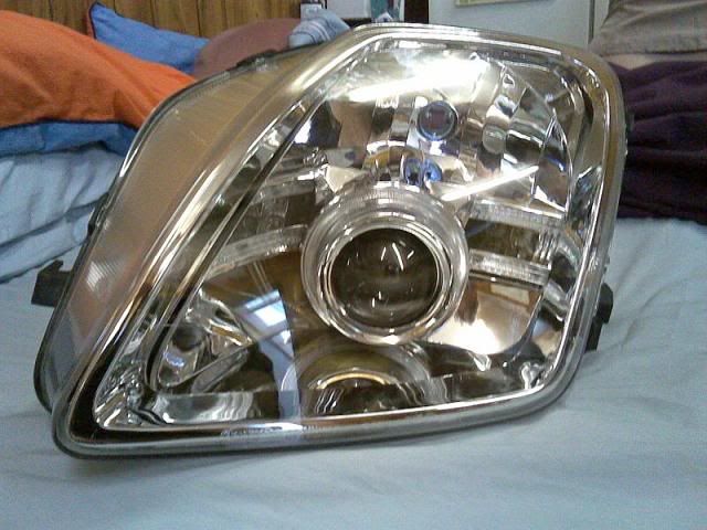

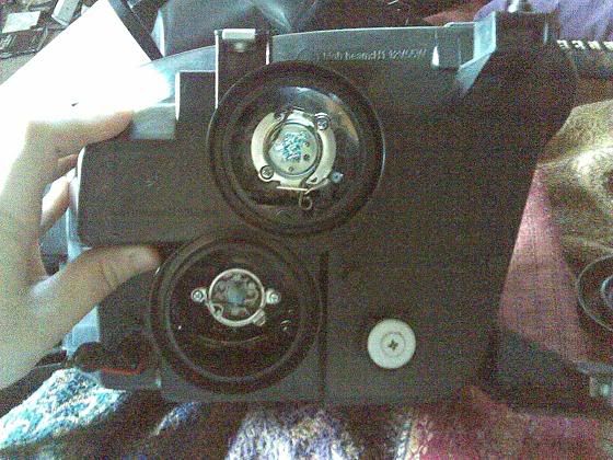

FIRST...you need to purchace a set of ebay projectors for the 5th gen lude.
these are the ones i got:

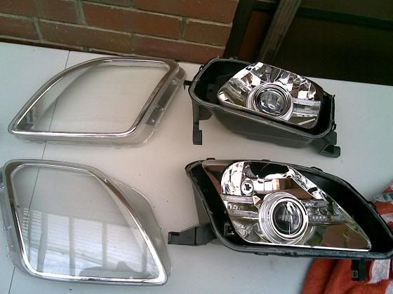

next you need to heat up the oven to 140 celcius.
once its at temp turn it off and pop a headlight in there.
leave it in for approx 7 minutes.
take it out...be careful not to burn yourself.
this should have gotten the glue nice and soft.
using the 2 knives pry the lens off the backing. you dont have to rush it...but dont be too slow as the glue will solidify again given enough time.
also make sure that you catch any strands of stretched glue before it lands on the reflector...dont wanna have to try to get that crap off.
repeat this process with the second headlight.
now you have to undo the hight adjustment screw on the back of the housing.
once this is all the way undone you can pop the reflector from the backing.
undo the 3 large screws around the back of the projector bowl
the whole projector bowl will now come out.
undo the 4 screws on the back of the projector bowl to pop it apart.

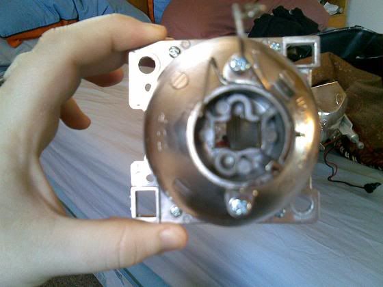

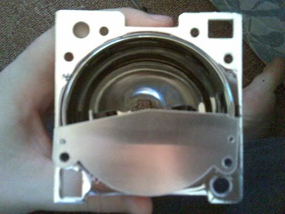

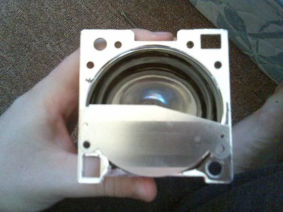

one its apart you will see the little metal shield. pick it up and put it back the other way around.
original way (lhd):
new way (rhd):
now reverse the process to reasemble the lights.
using the hotglue gun to reattach the lense to the backing.
now your ready to put them on your car and have fun.

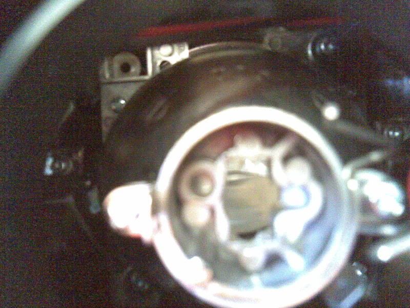

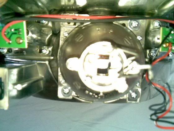

i found when i went to put the HID globes in that they wouldnt go straight in.
i had to get a small round file and file a small bit off the bottom of the globe slot.
photo isnt the best...but its only about 3x3mm files from the centre of the bottom of the slot.
then the globe goes in perfectly.

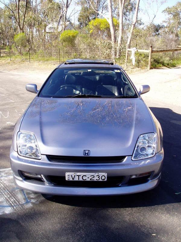

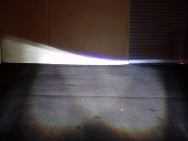

and secondly...here are some pics of them in using 6000k HID.
enjoy and good luck.
