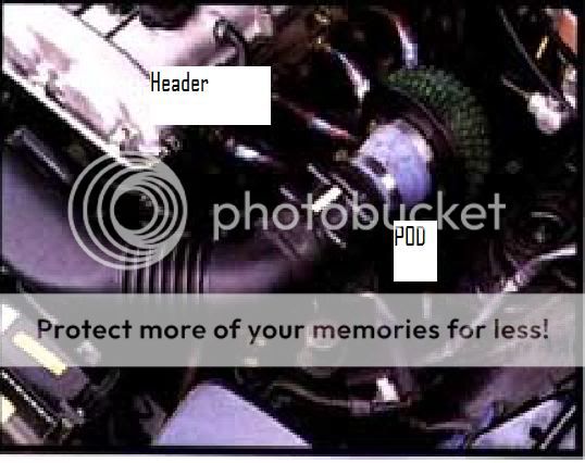

Big difference. The talk about SRI's being a futile design for DC5/2 is both relavant and restricted the the design of SRI for DC5/2, you probably got gains from your 180SX SRI because it is alot further away, which makes sense.
Here the end of the intake tube and filter sits virtually right next to the back of the engine where the headers are. If you've touched the exhaust manifold even after 30 seconds of the car being turned on you'll understand it gets f-ing hot back there :D

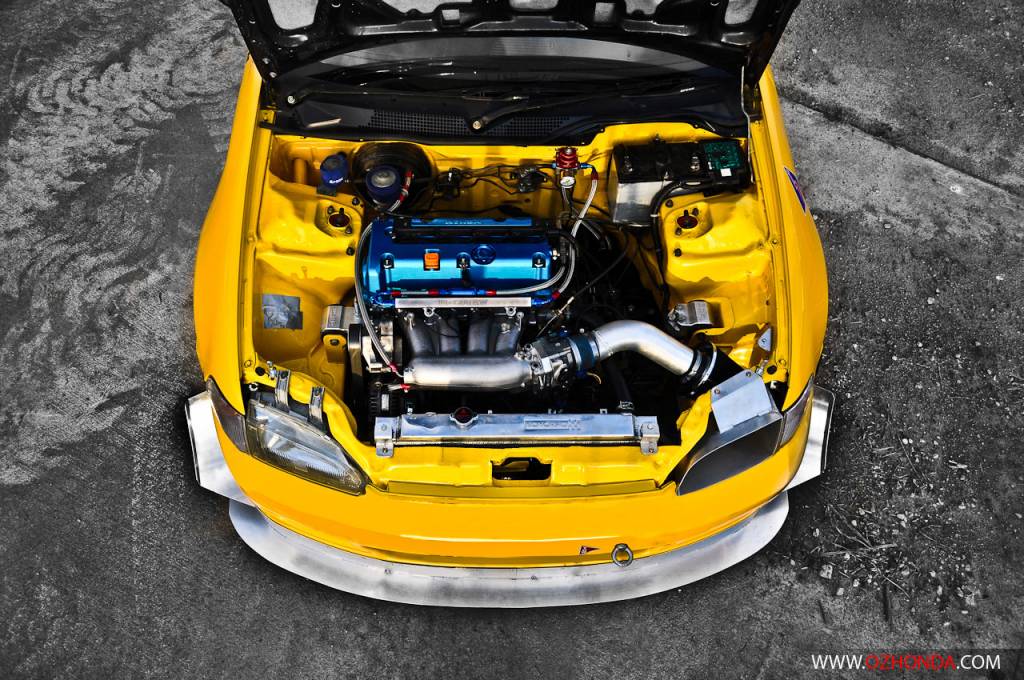

just look at flick's eg, he is running a sri for the track and that seems do fine
either way, SRI/CAI its all up to the users preference
he does?
Not the best angle, but I cant see an SRI
http://img508.imageshack.us/img508/2478/19082009153.jpg
And an extract from his for sale thread
thought he used the CAI for the track, correct me if im wrong
You're an idiot
Thats because it's an EG and it sits towards the front not the rear.
Theres no room to sit it in the bay at the front for DC5's
http://www.ozhonda.com/gallery/data/558/medium/327.jpg
ahh so he does. But that's a big difference to what we're talking about, heatsoak is an issue for the DC5 because as Tai said on his EG it sits in a different position.
Compare the position of the intake to the k24 layout on page one
what is your problem tai? i never attacked you or anyone in this thread, im just suggesting that either SRI or CAI is up to the users preference, either one has pro or cons
grow up
But look at hte passenger headlight, or wait, there isnt one! so the pod sitting there wont suffer frmo heatsoak. All teh cool ait is still being fed directly into the pod itself!
What I was referring to was the generalization of SRI having a heat soak issue as posted by some members back in page 1.
I was only stating that flick's eg has an SRI and how SRI dont always have heat soaking issues.

Well use commonsense.... With the pod right at the back of the engine... Its gonna suck up hot air... Engines run better with cool air... At the end of the day, theres gonna be mixed responses on both intakes...
@Lowiez Do you have any evidence that HEATSOAK robs a a significant load of kW while street-driving?, Give me a legit answer to that.
@SpoonS OK...let me show this middle-schooler an image so that it makes sense to him/her. ( I'll make it as reader-friendly as possible just for you ) The picture of a DC5 below shown by your bum-chum Lowiez is an engine bay area of a DC5. The header, you know what a header is?, an exhaust manifold is located at the back of the engine near the firewall and that charlie brown is where it generates heat. Now, the pod filter (SRI Type ) shown here is located away from the exhaust manifold and to the side not the back as some people claim its located at the back, lmao.
It will however suck in warm air because its open and within the proximity of the engine bay but kW-robbing HEATSOAK, no.
Get back to me if that still doesnt make any sense so that i can clear things & make a new thread titled " HEATSOAK on SRI, is it really a problem on a daily car " , we'll make a poll and have all these good people at OZHonda to decide. But hey, i shouldnt bother you anyway coz you're the one using an SRI for 3 yrs and find no problems with it and you know what i mean.

In case you didnt know what a pod and a header looks like which wouldnt suprise me, ive labelled it for youQuote:
You're able to find your valid answer on a Miata?....LMAO...have a look at the positioning of the header and pod filter jackass and try compare that positioning to a DC5. Then it'll be a different answer.
http://i383.photobucket.com/albums/o...wiez/miata.jpg
Very similar in both pictures, pods are in a close proximity to the header. Do you think hot air travels for only 2cm or so then instantly transforms into cool/normal air? fool.Quote:
That study is very relavant. The positioning of the pods are both subject to heat from exhaust fumes travelling in the header.
Miata = 1.8 4CYL
K20 = 2.0L 4 CYL
Similar capacity too, so exhaust fumes at lower revs (which is what the study is focused on) will be similar due to engines of close capacity with similarity sized combustion chambers pumping out similiar levels of exhaust fumes when working. Dont believe me? research engine combustion.
