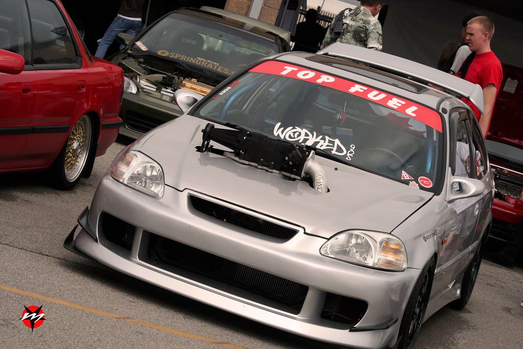

that jseries
would have to chop bonnet
prettysure
milkmun you do
http://s3.amazonaws.com/files.poster...sOaRq3CpM1o%3D
I never said simple. Just throwing up an idea. There is a guy from the east cost of America that has done it. Was covered in a Honda Tuning Mag a couple of issues ago
those photos were old news - my bad.
http://i374.photobucket.com/albums/o...7d555525_b.jpg
cheers tai
