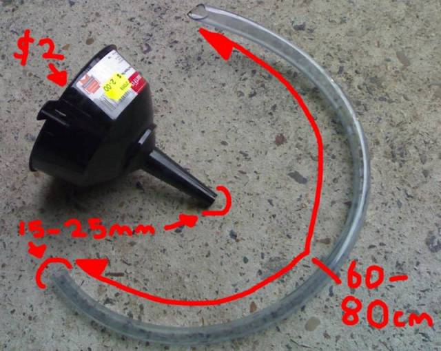

Aim: To make a easy way to fill gearboxes...rather than use a sludge pump from the normal "fill" hole.
Required: scissors. about 1m of tubing ( any sealed type) with a maximum diameter of about 2.5cms. Cheap funnel with narrow nose.
Cost = about $5 all up.
http://www.ozhonda.com/gallery/data/500/medium/FUN1.jpg

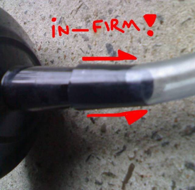

Grab funnel , and firmly push into one end of the tube.

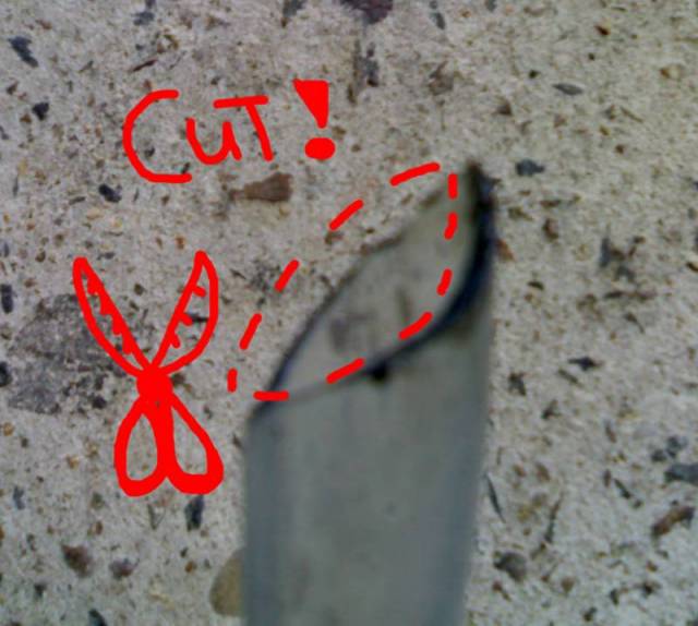

Grab the other end , and cut a diagonal slit into it. This is to aid in directing the fluid into the gearbox ( not to mention guide the end into the VSS hole)

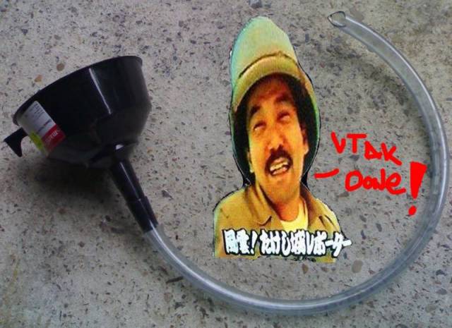

Thats it. DIY filler.

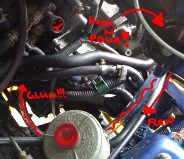

Simply place the slit end into the hole carefully , hold up the piping and slowly pour the MTF ( or chosen fluid) into the funnel. It will slide down and slowly fill the gearbox.
Put 2 containers in , then slowly top up with 3rd container. Should take about 2.3-2.5 litres.
When its full , it will flow a small constant dribble out ( look !)
