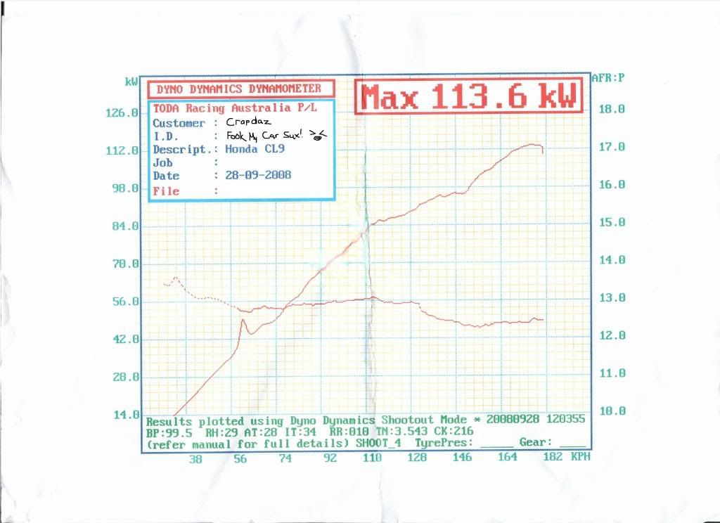

lol i think stock ecu sprays more fuel on vtec... from all the data logging ive done, cruising you sit about 13.5-14.5 depending how much you got your foot on the accelerator, WOT is around 12.5-13 consitently, and VTEC drops to 11-11.5...
aslong as it stays below 15, (while under throttle) i cant see the engine doing damage, youll just be losing power... as for people worrying about using the RBC and running lean... the ECU relearns it, theyre will be no problem.. :thumbsup:

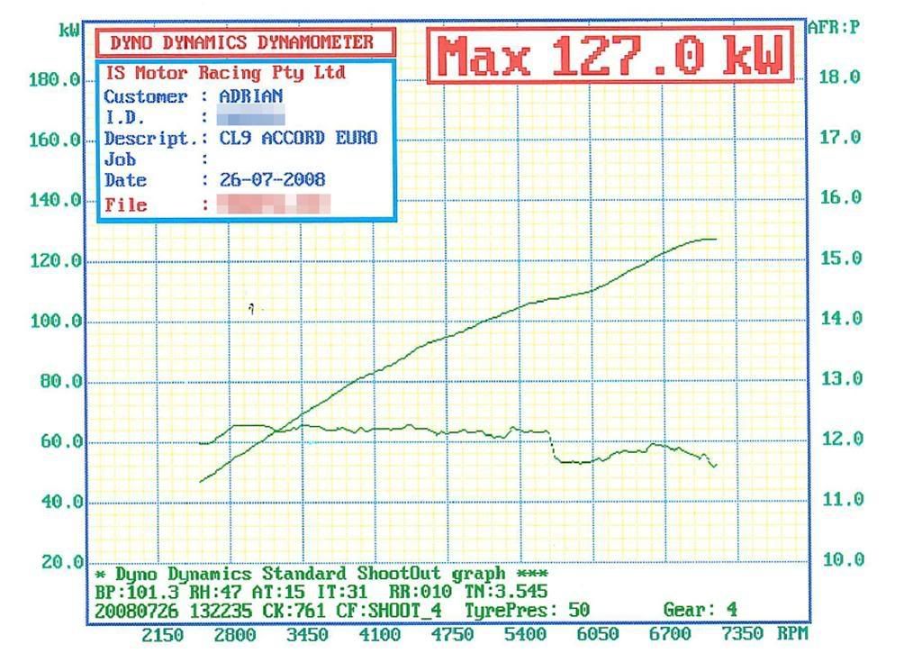

here is Adrian_Euro's dyno sheet anyway, you can see in his tune a definate richening up on VTEC :thumbsup: very sexy!
