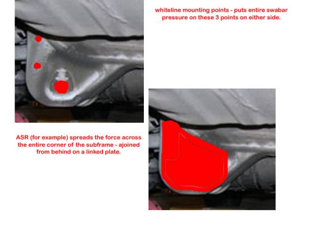

Guys , the problem with this design is this - a basic description.
http://www.ozhonda.com/gallery/data/...dium/rough.jpg
The same amount of force is applied to the overall RED areas shown above. The difference is , the whiteline has a much more concentrated force applied to those 3 smaller holes while the ASR brace spreads the load upon a greater plane. Hence , it is a better and safer product.
Please , if anyone can add or correct me upon these issues feel free. But this is a basic description and fact :)

Good description Ben. Something else to add is that the reinforcement at the back of the subframe is significantly less on the Whiteline kit than the ASR kit.
I think something very important to note here - in terms of driving feel both the whiteline kit and the ASR kit feel almost identical. For ek1 owners they are a huge upgrade from having no rear sway - as such handling is greatly improved. The Whiteline kit cant be faulted for improving handling. The issue is purely with the construction and design of the kit IMO.
So the problem with Whiteline here is not the swaybar, but the substandard reinforcement kit, right?
I don't understand why people don't just get the ASR reinforcement kit and use that with the whiteline swaybar.
