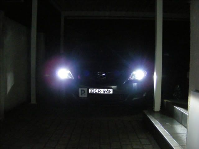

    I installed my HID the other day..car as halogen projectors. look like HID projectors.. but car came with halogen. The light seems pretty good.. did around 1~2 nights worth of testing to see if i blind on coming cars etc
    WITH HID KIT
    LIGHT CUTOFF WITH HID KIT (i have since levelled it to match the halogens)
    Standard Halogen Bulbs with Phillips Diamond Vision
    In the pics.. it looks like the halogens are brighter.. thats probably just my camera... the HID's produce soo much more light. They're currently 6000K.. might put in 8000K
