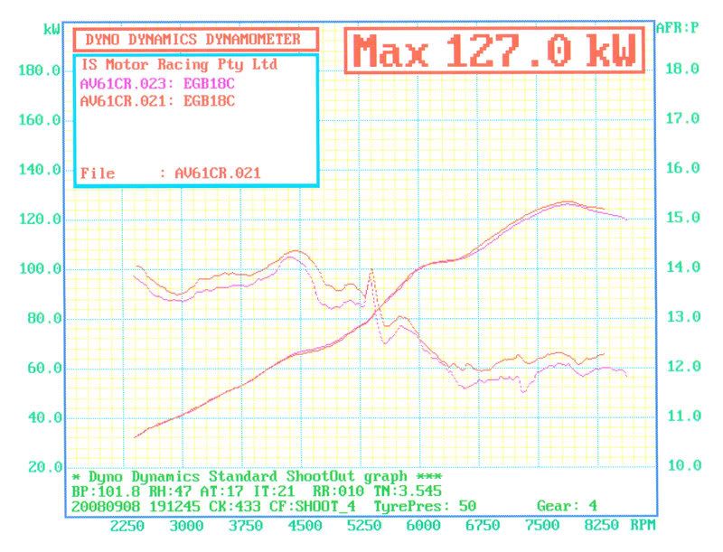

    Mistakes made again, yes the b18c5-7 type-r motor does use the same head design as the b16a but it is hand ported and polished far beyond the b16a head, this is why people think the b16a head is better when in actual fact its not better or worse its different, the b16a head and b18c2 head have slightly different port designs, also the b18c2 head has a 41.6cc combustion chamber vs b16a/b18c5-7 42.7cc combustion chamber so you do the math, personally id go the b18c head, dont ruin a good thing, dont mix and match for the hope of an extra 1-2-3hp or maybe 1-2-3hp less and the risk of a worse torque curve or maybe better torque curve and so on, hope this helps

    To be honest i think the b18c2 P72 head is the best platform for head work, JGengine dynamics from whome i got my b18c race head flows 315cfm on the intake ports, he said he cant do that on the b16 heads as there is too much risk of eating too much material for the head to still be strong. anyway they are both good heads but an unopened engine might be better/easier and even cheaper. but the main thing i would consider is what i said before about the combustion chamber sizing, also to add the b18c2 P72 head has intake ports directed better into the combustion chamber from factory.
